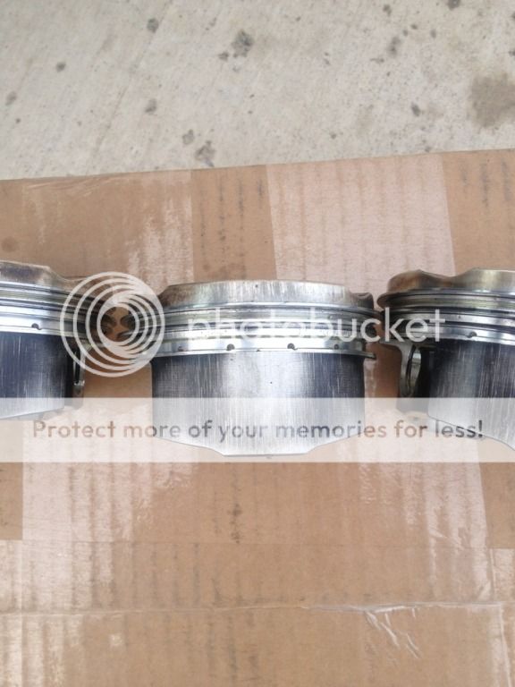

Hopefully things aren’t so bad. I’m sending the rods to GRP for inspection and repair. I also shot Dave a PM (Lets see if he even gets back to me lol.) in regards to his pistons. I seem to have excessive skirt wear so I’m not entirely sure whats up with that.

Could be because of the debris floating in the oil after the accident. Either way, I’m basically doing a full rebuild at this point. The block and new crank were dropped off at Klispies today for inspection and repair.
