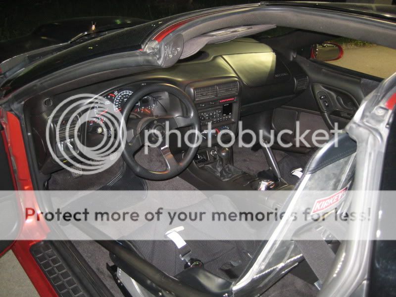

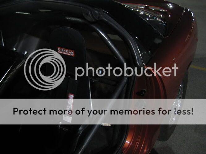

prodrags here, really like them. The economy have that kidney thing that sucks. Put 2,200 miles in a weekend, just take you wallet out, nothing in your pockets after 4hrs will hurt you, the hold you in tight. Never got any pics since I painted them last year. I don’t have any good pics of them really.
You can come and try them, I have a pair in my car. And mattP BLKWS6 , were putting on set in his car this week too.
I saved 33.9 pounds with them over my stock cloth seats.
And RJS camlock 5point harness were 1.76# lighter then stock setbelts.

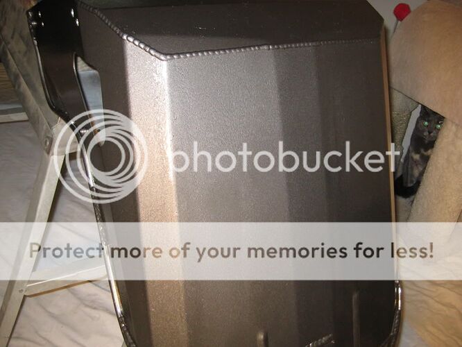

Kirkey prostreet Drag 12.13 17inch pn-41700 no cover each
Kirkey seat cover- 2.455 17inch, black cloth/tweed, each

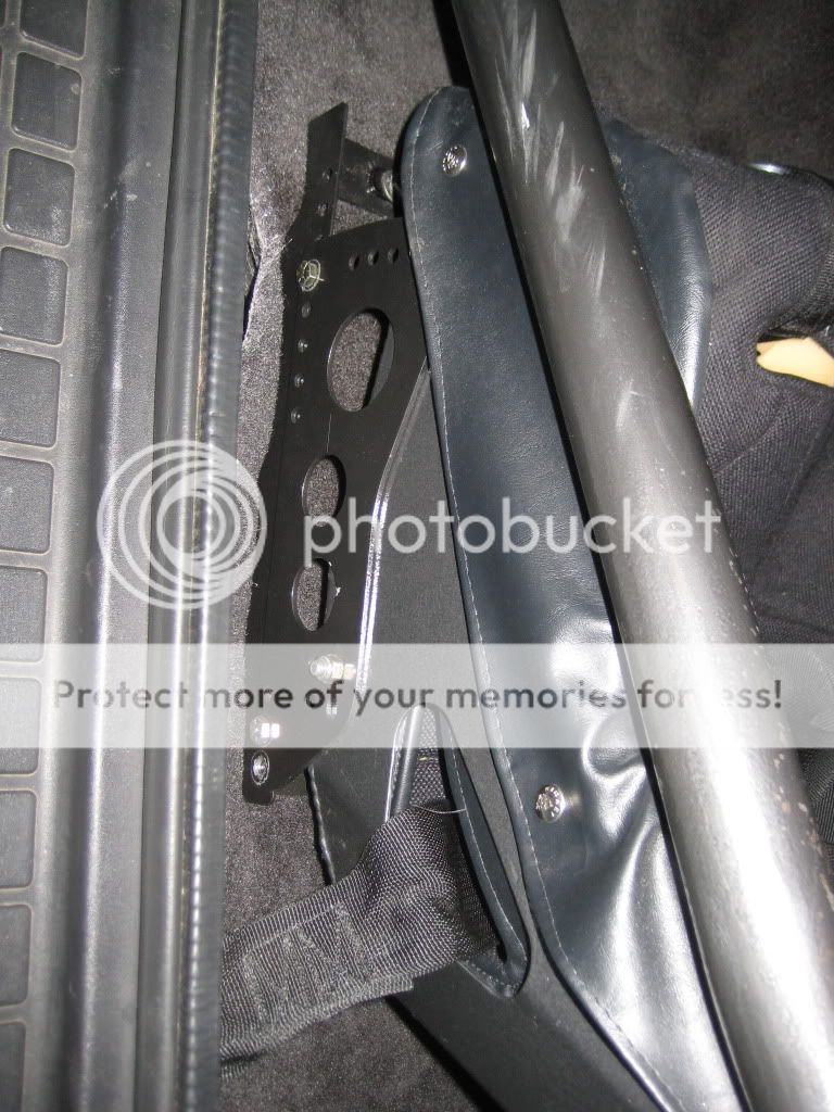

Racecrafter kirkey seat brackets- 6.045 Bolt In style, 1 driver 1 passanger (pair)

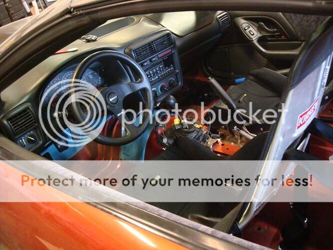

[/COLOR]found this pic, of them painted.
^ His Kirkey’s are pretty comfortable. I’ve ridden with him to and from nyirp and it was fine.
