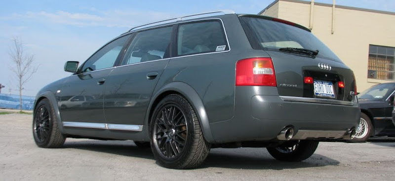

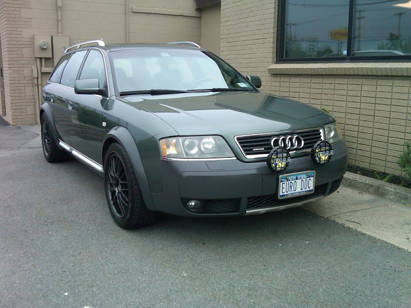

Oh, and the car itself for anyone who hasn’t seen the fat wagon.

That is a good looking car and must scoot pretty well.
It goes pretty well considering that it’s 4100lbs, dry.
