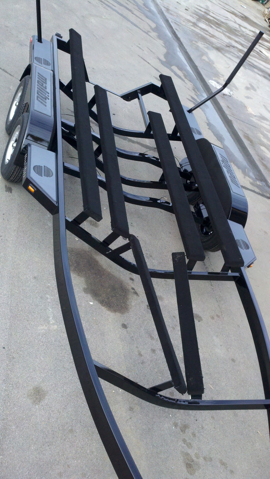

I don’t have any pictures of mine without the boat on it, but this is the setup to have on a small boat (15-25’):
http://images01.olx.com/ui/10/97/47/f_393939047-3514027396.jpeg
Trailmaster, exact same design as mine. I know you said the trailer on the one you got needs quite a bit of work so if you’re already tearing it all up now is a great time to make it into something useful. If you’re going to launch/retrieve each time having a trailer that works properly is essential to enjoying your boat.
It’s self centering, easy loading/unloading and the boats sits low on the trailer so it’s stable as hell at highway speed.

After seeing the pictures, I’d consider swapping that to a bunk. Good roller trailers have A LOT more rollers to get the boat centered and stable on the trailer.
With good bunk carpeting, you will have no issues with the bunks damaging the bottom of the boat.
If you want you can come check out the bottom of my 12 year old Chaparral that has been launch/retrieved on average at least once a week from May till Oct. Not a mark on it from the bunks. Gotta remember that the bunks are carpeted and you 95% of the weight of the boat is supported by the water when it’s being dragged onto the bunks (and it floats off).

We’ve got a boatmate like this one now:
A good roller trailer looks more like this. Notice there are a lot more rollers toward the front to help line the boat up as it comes up.

For me it would depend on what kind of shape the roller mechanisms were in. If they’re all mess up, not rolling, needing to be replaced etc I’d switch it to bunks. If they’re all working fine I’d just sand it down, prime it and hit with with some paint. Look at the pictures of the bunk trailers that were posted. It’s not exactly rocket science to put bunks on a trailer. If you can weld or know someone who can it’s just a matter of installing a few brackets and covering some pressure treated 2x6’s in outdoor carpet.

Will it fit down between the fenders like this?
http://farm2.staticflickr.com/1269/537609652_d75c3ebe17_z.jpg?zz=1
its close but yes it looks like it will fit down in between. close where i would probably want to put some carpet on the backside of the fenders, but i can also move the fenders out an inch if needed, theres plenty of room. i would like to get it to sit down a good foot lower though so i need to make all kinds of changes. it has separate “axles” for each side that the hubs ride on instead of having one solid axle so that would help.
