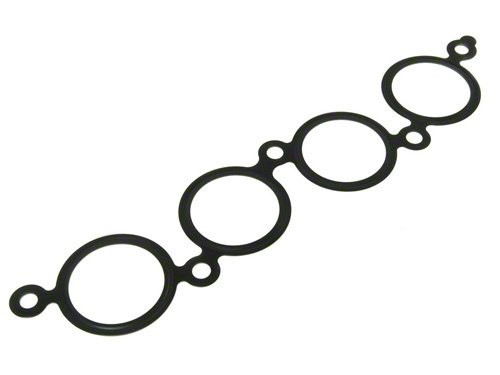

Either way when I hooked the cold pipe back up to the trottle I immediately found a huge leak at my intake collector (gasket between lower and upper intake). I couldn’t get the boost gauge above 3psi. This collector gasket seems like a huge pia to find. Only place I could find it was enjuku
Anyone know if that is a common part with an other nissan NA vehicles? Can I get this gasket somewhere in canada? If not can I use sealant or do I have to pay 3 times the amount to ship it from enjuku.
varun should have that gasket
^ good call he has one.

no don’t use rtv just buy the gasket maybe frsport will have cheaper shipping or someone on ebay
Bumping this as I still need guidence with how to properly pressure test your motor. Gasket issue resolved and fixed.

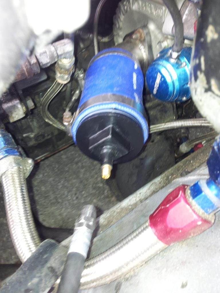

The end cap with the tire stem gets clamped into your intake. Make sure it is after any other piping (re cir bov or crank case vacuum line)
http://img.photobucket.com/albums/v282/tamboman/2013-06-25190747_zpsd9959bcc.jpg
To test the IC piping put the other end cap with the vacuum line blocking your cold pipe to the throttle body. The vacuum line then runs to your bov. You also need to block off the idle air line. Once that is all in place squirt soapy water over all the conection points. throw your loonie in the pump and hook it up and watch for bubbles. Having a second set of eye’s is almost required.
Pump it up until your IC can hold your boost pressure. Note* be carefull not to put your face in front of any of the blocks or pvc end caps you’ve made. Mine were able to hold 20psi without issue but I am not responsible if you lose an eye!
Once you have confirmed there are no leaks in the ic piping hook your cold pipe back up. Now spary all the intake gaskets, fuel injector o rings. throttle body, and vac lines. Open your oil cap then hook the air up to the intake stem again. I just run the pressure until it reachs my boost level. I found if I had any leaks it wouldn’t let me get over 5psi. I’m not sure what the cfm of a gas station pump is but it seem’s to work well. Once I had all my leaks fixed I could get it up 20psi. I didn’t bother trying to time the rate it leaked out.
