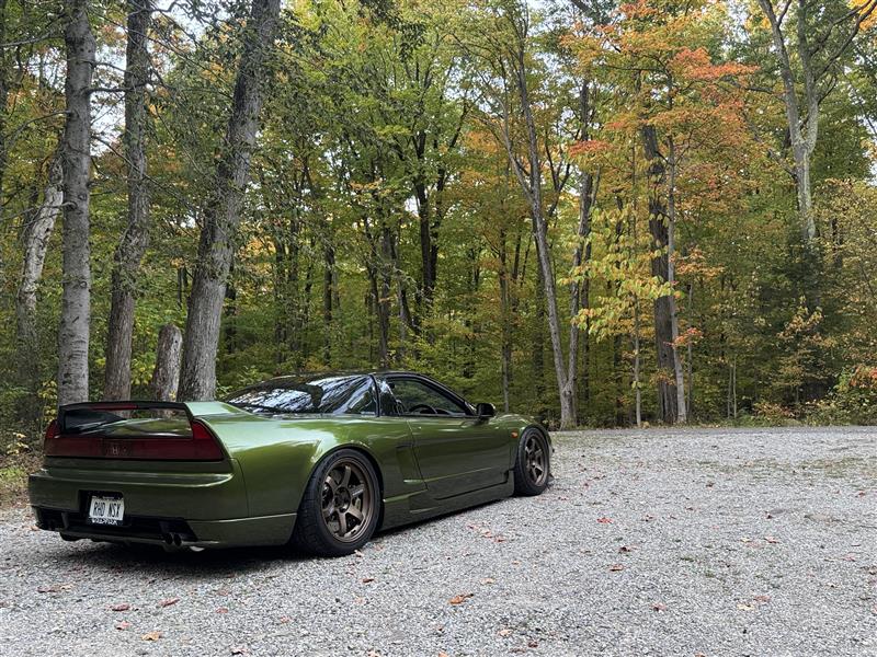

I’ve been driving the car around most of the summer, but made some changes last winter//spring.
I put a “TYPE R” hood on it as well as some LED taillights. The LED tails I really like for the 80s vibe.
I also put a TVS blower on it and it dynoed at 430 wheel on pump gas which now really makes it a lot more fun to drive. By no means is it FAST but it’s at least zippy now.
Here are some pics. Also like ONE person at the BATTLE AT THE BORDER thought my GAP CAM was funny. Whatever. LOSERS.
this car is sick and you should come pick me up in it.
This car is epic, so well done
Very nice, the tail lights remind me of the old 80’s Impala tail lights.
