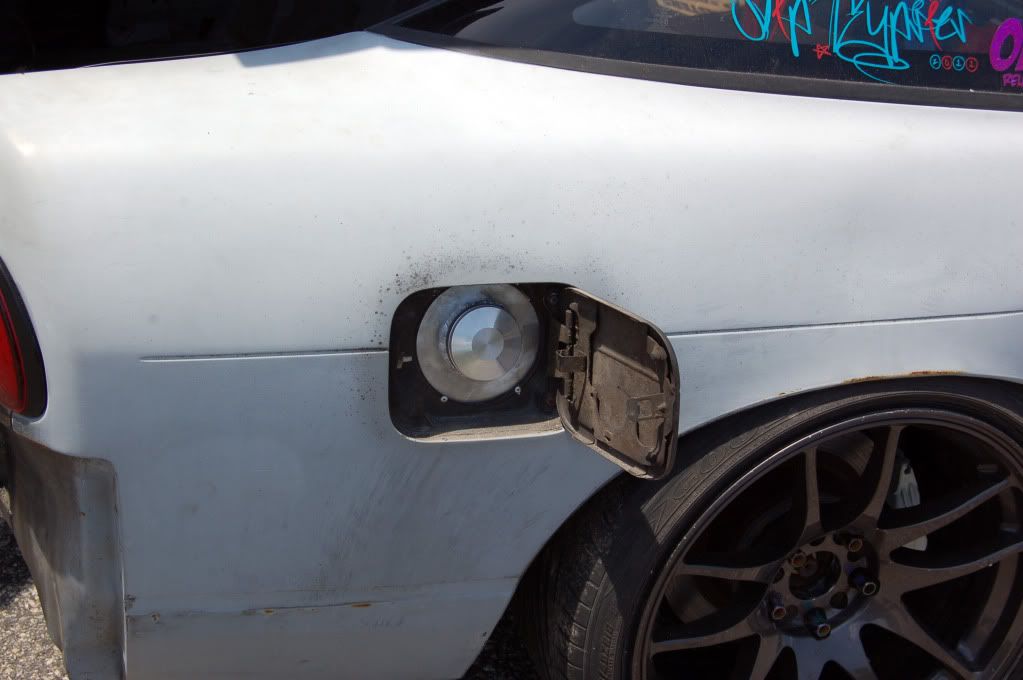

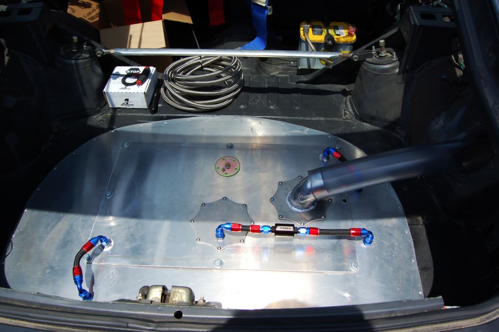

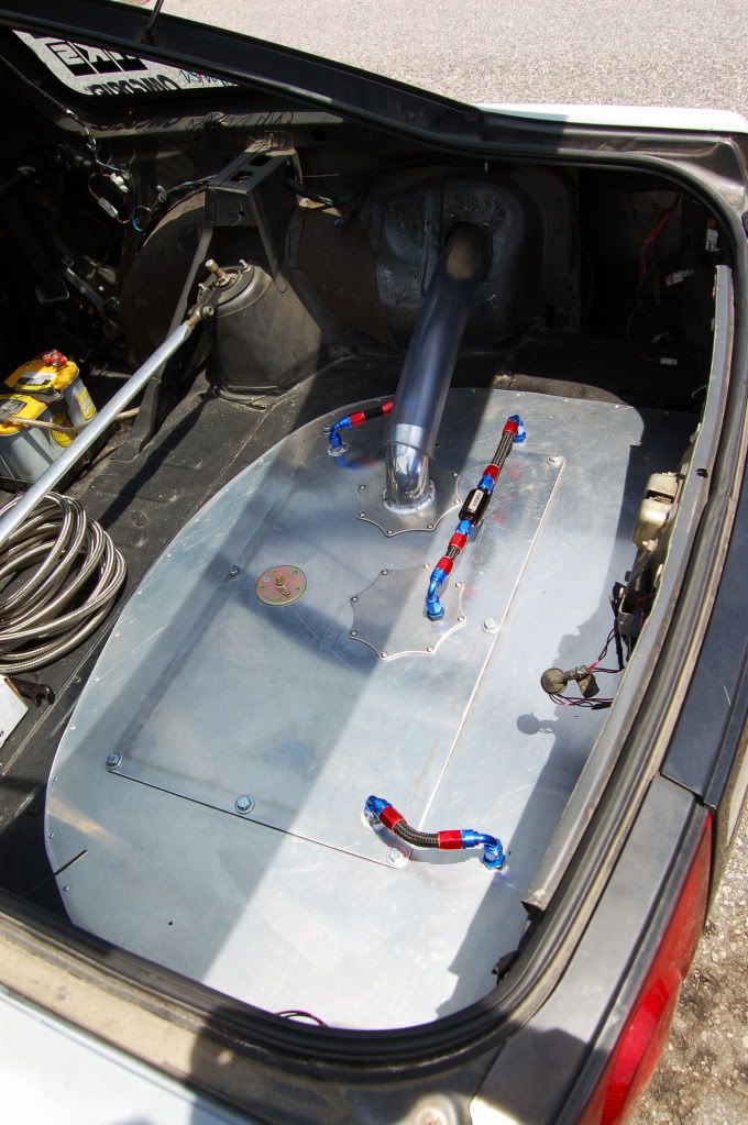

This guy I just saw on zilvia, i contacted him and waiting for some info, from what i gather he welded the fuel cell setup himself.
Love how they look and im sure they can more than handle the power for my goals…
This is pretty damn sexy:

trust me your wasting your money if you buy a pre setup kit. Do you research and plan where you want stuff to be. buy the pumps, buy the lines and fittings. I’ll be at cscs this weekend with a buddy who spent a whole winter planning his fuel system on a fc. take a look at it.
