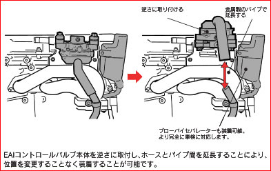

I think Dustin is right… it seems to me like it’s an AIV-type unit where it takes fresh air and dumps it upstream of the cat to either help light it up quicker or to somehow clean the exhaust gasses? It’s somehow designed to pass Japanese emissions.
The HKS transfer kit is basically a relocation of the EAI unit and an extension of the tubing that is designed to work with HKS exhaust manifolds (because the stock EAI will not fit with an HKS manifold).
On S13s it’s located on the exhaust side of the engine, at the top of the head.
In this pic you can see it, it’s the gold diaphragm with the tubing leading out of it, just to the right of “CAM” on the valvecover.
http://www.nissan.co.jp/MUSEUM/SILVIA/S13/IMAGES/g_4.jpg
Also visible here:
http://www.tomei-p.co.jp/_2003web-catalogue/000_expreme/each-product/each-product_img/sr20det_exhaust-manifold/ph_eai_ps13_taiou.jpg
