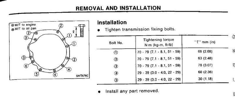

Does this help?
and I’m pretty sure the bolts are 14mm . . .
Yeah, that helps a whole lot! Thanks.
It still dosen’t answer the question as to which bolt size and thread pitch I want.
So you’re pretty sure they’re 14mm threads? I wonder what thread pitch…
