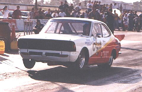

you should totally just buy my corolla :hsdance:
some encouragement :smiley:
http://www.dragtimes.com/images/5964-1980-Toyota-Corolla.jpg
http://www.bigflea.com/corolla/images/drag_corolla.jpg
http://www.buschurracing.com/images/racing-corolla4.jpg
http://www.sdsefi.com/features/te1.jpg
http://www.dragtimes.com/images/7165-1981-Toyota-Corolla.jpg
