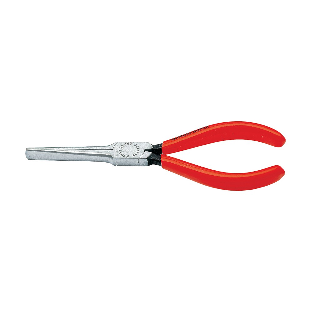

a small straight edge screwdriver duckbill pliers would work decently in this application.

there is no need for pliers in this situation, it would probably tear the fins.

mini screwdriver is good for getting them to stand up somewhat again, pliers work well for straightening them flat so they look decent and dont block flow to whats behind them.
they wont rip them. just give them a squeeze to flatten them and release.
