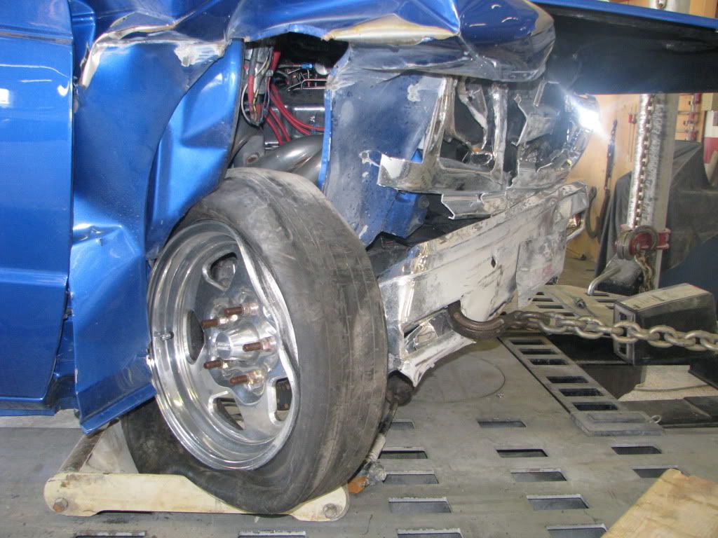

I’d advise against doing that extensive of a restore on a car thats going to be tracked in the 9’s. Too much varible that can end with the wall, and you out 15 k on a chassis that isnt repairable because its unibody.
For reference we had one of the s10 guys devestate his truck. shattered the powerglide case, broke the start ear off the motor, destroyed the truck entirely. Just saying hes out a chassis / body too, but its considerably less than a 15k shell.
and s10s have a full frame
pics from when it happened
http://www.s10racer.com/board/showthread.php?t=5647
the aftermath
http://www.s10racer.com/board/showthread.php?t=5813&highlight=rebuild
