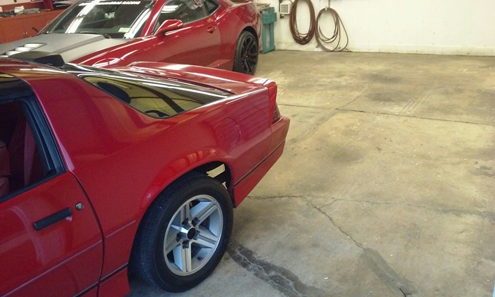

Here’s a pic of the outside. It’s big, 49’x24’. Can fit 5 cars easy, but i’m pretty sure I’m only doing the floor on the right side (for now). There is a bay on the left and I want that to be the “work” area so the rest of the garage doesn’t get filthy dirty.

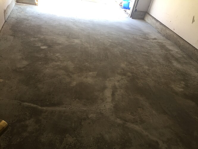

There are a few cracks in the rest of the section but the concrete is perfectly flat. Pretty sure the previous owner put some silicone in the cracks so that will have to come out since the Rust-Oleum won’t stick to it, from what I’ve heard.

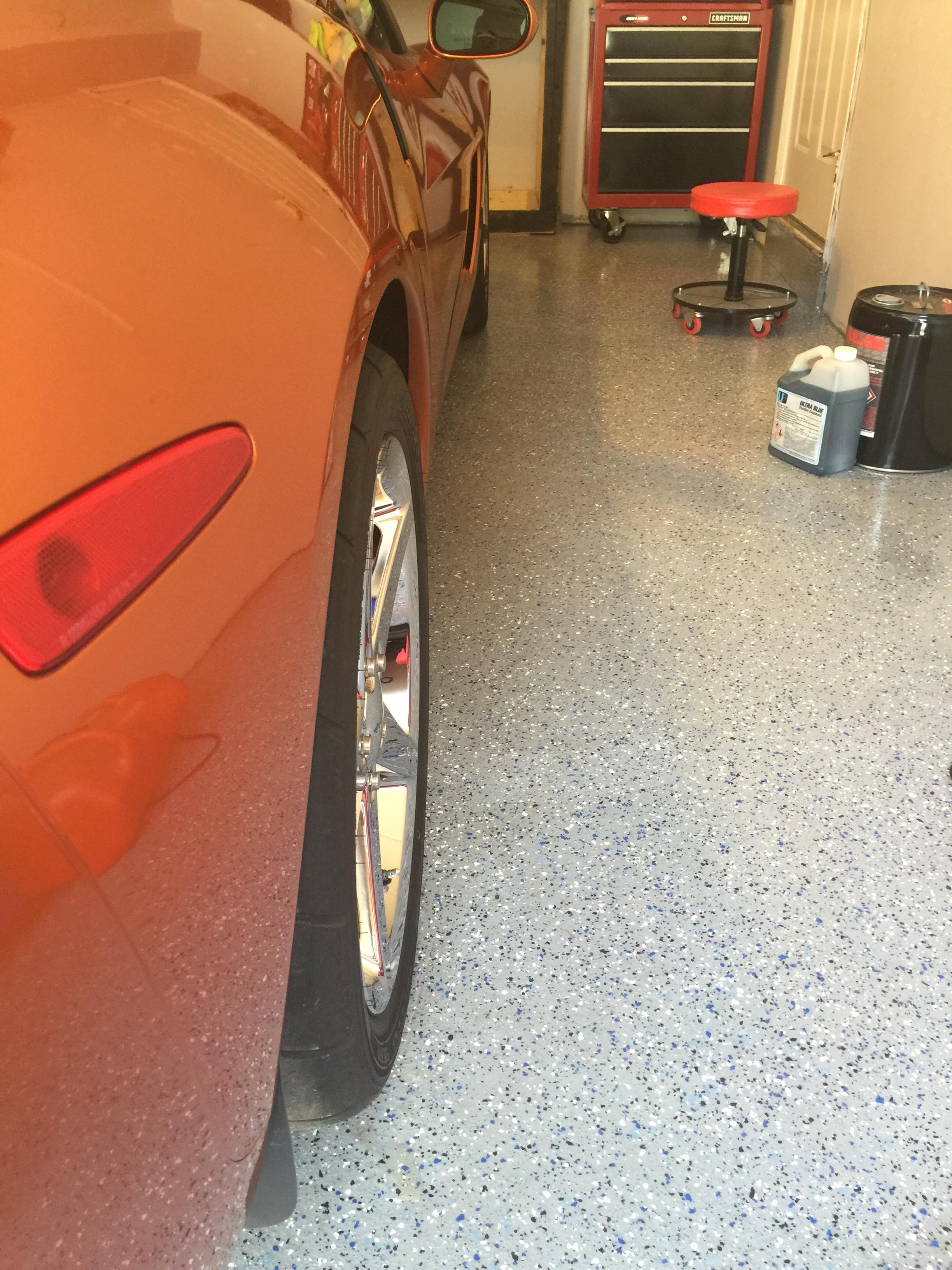

Choko and I did mine a few years ago concrete was pitted and in bad shape…We leveled it with more concrete did some acid washing couple coats of base and clear. Used the Rustoleum kit or should I say kits if I was to do it again I would definitely buy the stuff in bulk offline instead of from home depot.
I’m selling the house next year but how screwed the garage floor was I assume it will add some value I think was into supplies around $600ish
It’s been rock solid though hot car tires, e85, brake fluid, and dropped tools no issues

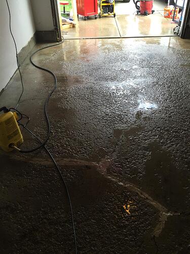

I’m going to let the paint dry for a week, and next weekend I’m going to degrease the floor and get it ready for a skim coat of concrete. I don’t expect a perfect finish because the one corner is raised up a bit, but I’m optimistic that it will look tons better.
Is your floor all pitted or something?
