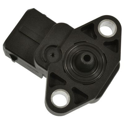

So the car was having a problem where it stalled after it warmed up. It had P0450 which it says is the fuel tank pressure sensor. Originally I bought this part from autozone.
http://contentinfo.autozone.com/znetcs/product-info/en/US/wl2/SU6415/image/4/
Pull the access panel to the tank and there is no sensor there. I end up taking it to a mechanic I trust cause I’m stumped and don’t have a ton of time. He changes what I think is the vent solenoid behind the gas tank. He said his Snap on reader was picking up nothing from it. It is next to the charcoal canister and has vacuum lines and an electrical connection going to it.

Car was running fine for awhile then the light came back on and is stalling again. Does anyone know if that sensor I bought actually belongs to this car? It is the same sensor that is on the intake manifold but I can’t seem to find it in the evap system.

It isn’t a duralast part, it actually has a Mitsubishi logo on it. But that is besides the point, the part I bought never went on the car. The vent solenoid that went on was from the dealer.
