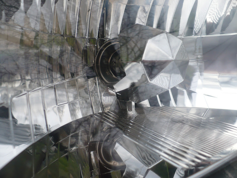

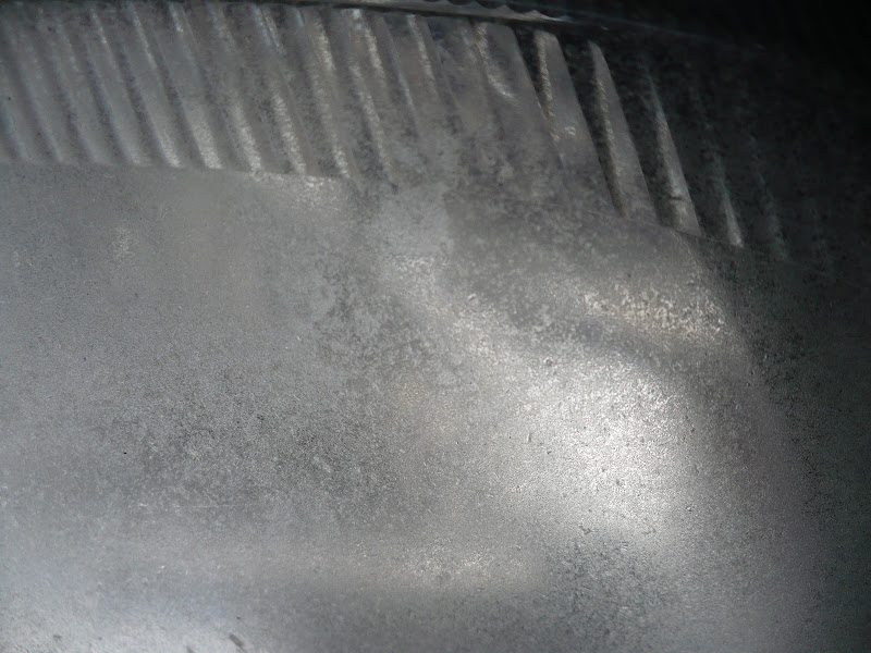

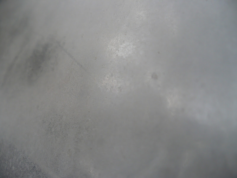

Its a lot of work but the results can be pretty amazing. Here are the before and after pics of my 208k mile headlights:
