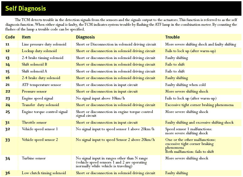

Edit: I think that yours is probably electronically controlled. I found this article that shows how you can get the codes. It says the ATF light should be on if it detects a problem.
http://endwrench.com/images/pdfs/4EAatPh2Win04.pdf
