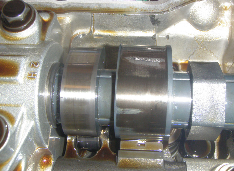

I’m wondering where you got that information from. You can be in Vtec all day long with no problems at all, do you think a gsr track car is ever below 4400rpm?
Experience? How many racetracks do you know of that keep the throttle on the floor for longer than 45 seconds? The valvetrain is a wear item and is really only designed to be used for 2 seasons with high lift/duration camshafts. Locking the valvetrain to run on the higher lift side of the cam will only speed up the wear on the cams, rockers, and retainers. I was a Honda technician for a very long time. I pulled apart an Odyssey v6 once that had a dead miss on one cylinder. Turns out the rocker pin inside the rocker arm had gotten stuck and ridden the Vtec lobe on the cam until it completely wiped the lobe to the point that the valves no longer opened.
Engine oil without Zinc and ZDDP(removed from most modern oils to keep the catalytic converter and other emissions equipment from destroying its self) aren’t designed to handle the loads that a high lift high duration camshaft puts on the valvetrain for long periods of time. Which would be why a “racecar” uses race oil, that contains zinc and phosphorus(ZDDP).
http://i25.tinypic.com/t7ejdf.jpg
http://i31.tinypic.com/iyfr0k.jpg
I can verify that these motors can be locked into VTEC all the time with no issues what so ever, hell a lot of k series guys do that for daily drivers. Ive been part if a dirt track team where it’s at 6000+ rpm for hours at a time with no abnormal wear (cams are same material throughout, as well as the rockers)
I do agree that the oil is recommended
Doing it on a daily driver is just stupid. All it will do is sacrifice horsepower torque and gas mileage below 5000 rpms. And again valvetrain wear depends largely on the cams. Factory cams will most likely be fine but cams like skunk2 pro1’s REQUIRE you to use oil with zinc and phosphorus or it will void the warranty on your camshafts. The ramp rate, lift and duration of the cams is too much for the valvetrain (and camshaft) to handle without the zinc and phosphorus in the lubricant.
