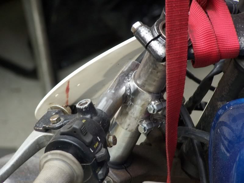

It is a bastardized clip-on for a 35mm fork tube.
At work we have a cheap laithe/drillpress/mill combo machine.
I’m not sure its really worth the hassle.
I could buy pretty ones for $150, or weld some 7/8" tube to a metal sleeve for really cheap. ( I am really cheap, I might add)
I made a quick sketch after looking around for clip-ons.
I’m thinking the hardest part is the .875" hole at a 7 degree angle.

Well, and without CNC (or a rotary table and some serious skill) you won’t be making those pretty rounded corners, and you’ll need a boring bar for that hole.
^I was going to say, making a functioning set should be fairly simple but they will look pretty sad. lol
