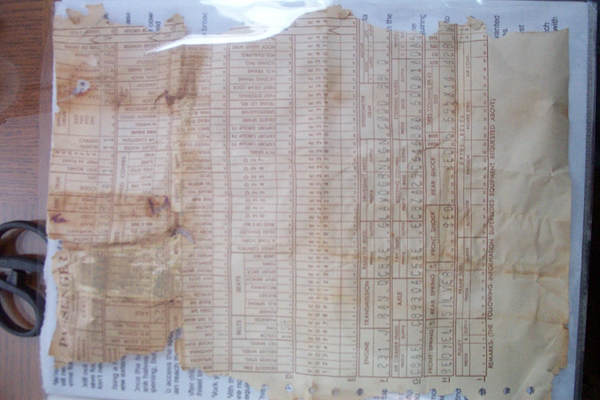

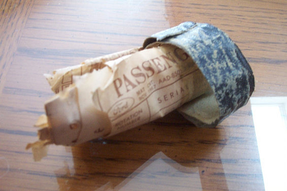

Again, I feel like an archaeologist. Inside and all wrapped up was the original build sheet. Usually over 40 years this shit is long gone.
Got lucky again.
http://www.supermotors.net/getfile/478613/fullsize/build-sheet-rolled-1.jpg
It’s a whore to unwrap, but I got it all set. Pretty bitchin’.

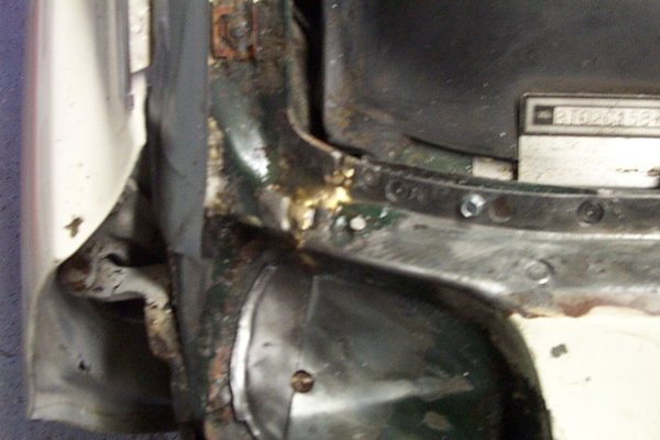

Pic of the Ford brazing. Not sure why this was done in the first place.
http://www.supermotors.net/getfile/478617/original/brazing.jpg

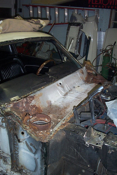

Nearly done on the removal, there’s a lot of hidden welds. Subfarme is chocked off, and I pulled the export brace and front suspension to get at the rest of it. Got held up when the bit broke, back on track now.

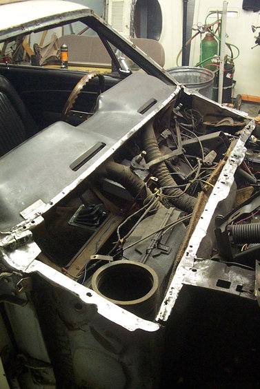

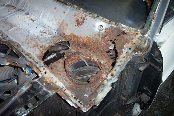

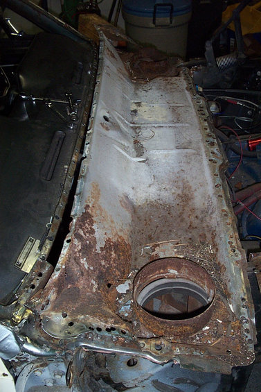

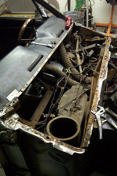

It’s been a while since I’ve updated, but I’ve been waiting on parts to get in. (Still am, actually, the cowl is backordered :frowning: ) I seperated the cowl halves last night - It needed it. There were about 200 or so welds I had to locate and cut.
I found about 3 pounds of needles, bugs, and rot in each of the drains. The lower panel was rotted through in about 4 different places.

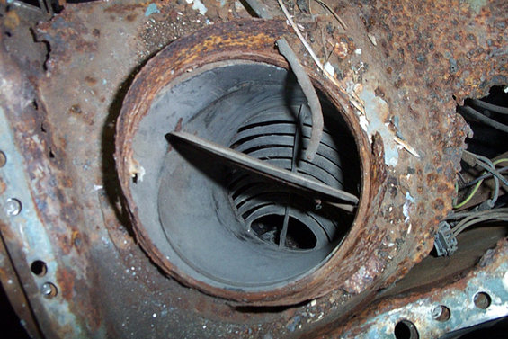

I know that these cars weren’t meant to last many moons, but I just pulled out a structural piece that was my defroster plenum - made out of something interesting.
Let’s just say that they went the short route :lol:
Yeah, this needed to be done.
Pretty bad shape!
http://www.supermotors.net/getfile/489825/fullsize/rusty-cowl-bottom-2.jpg
http://www.supermotors.net/getfile/489824/fullsize/rusty-cowl-bottom-1.jpg
Lower out. Closest to camera is the heater and defroster.
Welds ground down and the entire mating surface cleaned up with a flap disc and lightly oiled to inhibit rust. Look at that bling :slight_smile:
I am still waiting on the cowl panel to show up.

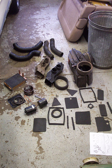

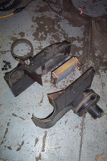

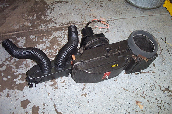

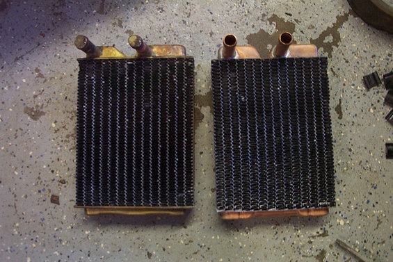

In the meantime I decided to rebuild the heater and defroster. I wasn’t gettin anything out of it and the cable controls were binding.
Maybe this is why. Left is old, notice what I can only describe as “plaque.” Ugh…
http://www.supermotors.net/getfile/489813/fullsize/old-and-new-heater-core.jpg
Here’s what I was talking about before - the defroster plenum. When this car was made, it obviously hadn’t been designed to last 40+ years.
But still, who does this :lol: I give you, structural cardboard:
About the consistency of that potting cardboard you find at Lowes.

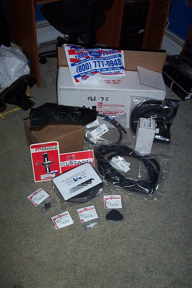

All the stuff for the rebuild. Used new seals, core, motor, defroster and tubes. The heater box was cleaned, disinfected, and duralubed up.
http://www.supermotors.net/getfile/489815/fullsize/rebuild-kit.jpg

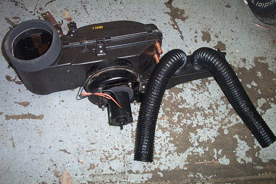

End result.
http://www.supermotors.net/getfile/489819/fullsize/repaired-heater-system-front.jpg
http://www.supermotors.net/getfile/489820/fullsize/repaired-heater-system-rear.jpg

Holy cow… Your cowl was wasted. 60’s Mustangs were notorious for the cowls to rot out near the top hat.
:tup: to doing it right the first time
The proper term is “hole-y shit.” I’m only holding onto it to align the lower when it gets here, then that bitch is trash.
