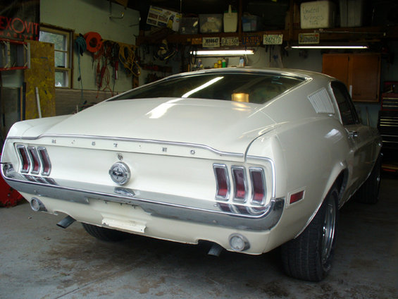

Well, after many many moons of looking, almost-purchasing, couple of bodily threats, (
) etc., I finally found one. Been a big dream of mine and it’s here. Enjoy fellas (and ladies).
1968 Mustang Fastback C-code

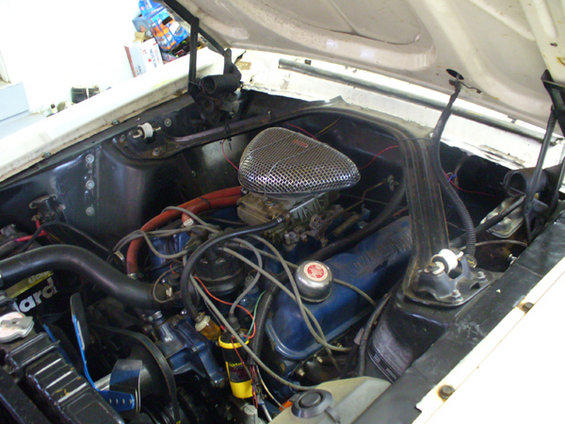

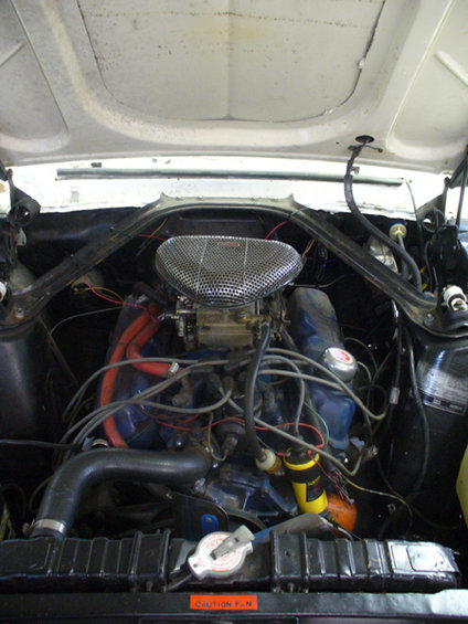

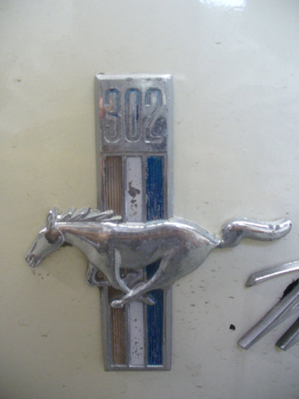

Engine:
Stock 302
Upgraded to 4bbl 4160 Holley carb (rebuilt)
Holley electric choke kit installed
Pertronix Ignitor I

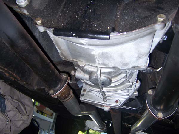

Driveline:
Tremec TKO 3550 5 speed transmission
10.5" King Cobra cable clutch with Dual Friction disc
Ford Racing aluminum flywheel
Cable clutch pedal conversion with pivot bearing
New u-joints on balanced shortened driveshaft
Stock 9" rear end, 3.0:1 limited slip (Trac-Loc)

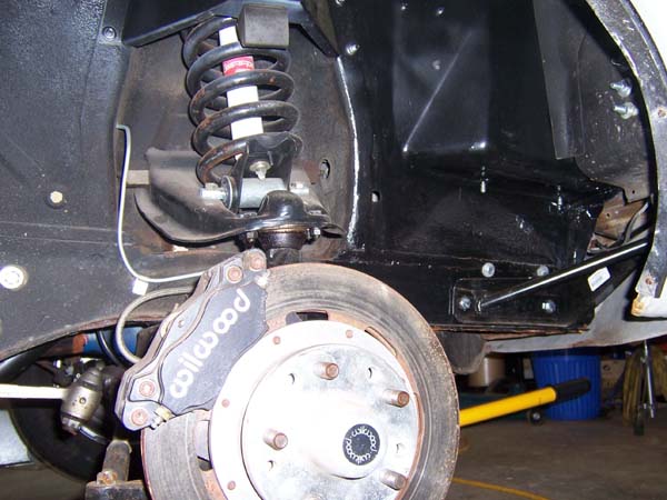

Brakes:
Front: New Wilwood 4 piston Dynalite 11" front disc brakes
Rear: New drums, shoes, springs, slave cylinders, e-brake hardware
Stock dual resevoir master cyl, manual (no booster)
All new brake lines with stainless braided flex hoses
Wilwood proportioning valve
Suspension Front:
New upper/lower control arms
New spring perches
New ball joints
New strut rod bushings (rubber)
New 1" front anti-sway bar
New KYB (white) shocks
New 620# drop coil springs

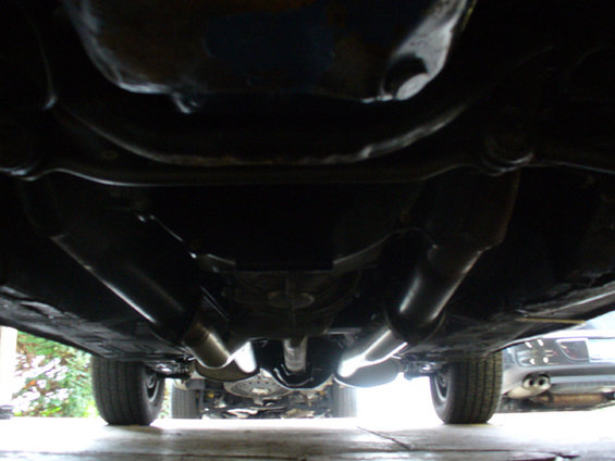

Exhaust:
New Tri-Y headers
Mustangs Unlimited aluminized turbo mufflers
New 2" pipes all the way back

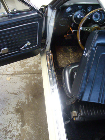

Driver’s door restored (new window regulator, linkages, latch assembly,
exterior handle, sealed interior metal with POR-15)

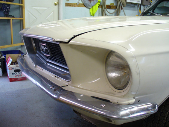

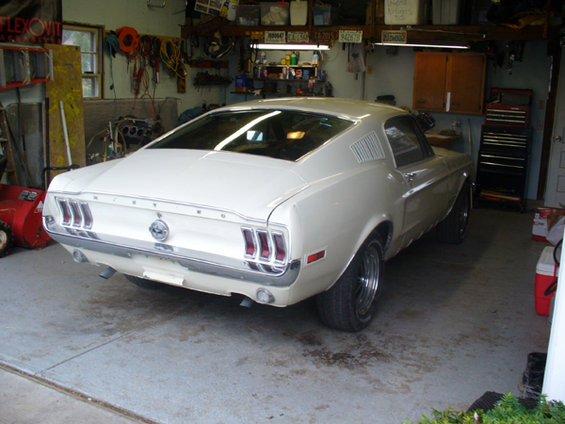

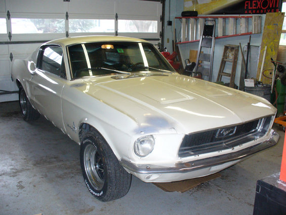

Here she is.

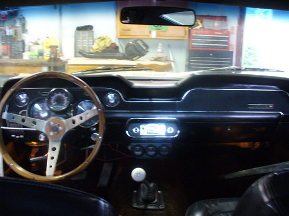

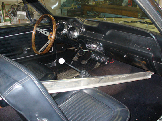

OEM dash. Interior needs a carpet and some goodies.

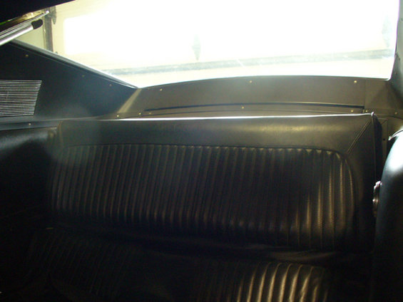

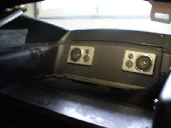

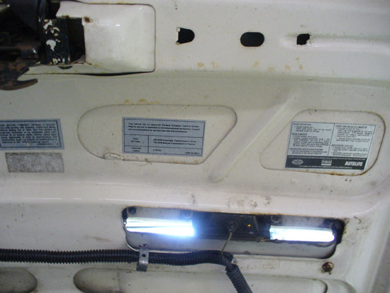

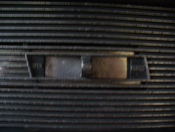

Rear air extractors. Sorry 'bout the bluriness.
