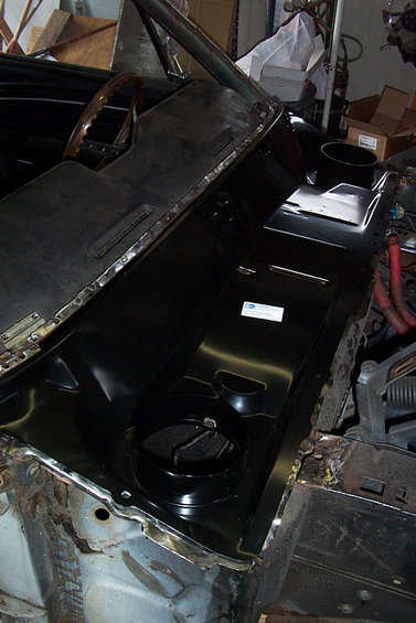

Cowl came in yesterday.
What a great piece, really quality. The finish is dipped, Slots into place nicely. Have to get the grinder back out and get the edges ready for welding!
Here’s the old one, you can see the 463939628 welds that held it in place.
New panel test fitted, looks like this should work out great.

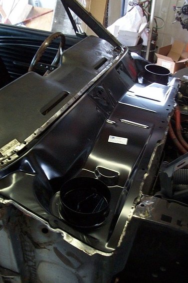

Well, cowl’s done.
Welded in the fender extentions last night, POR’d the whole shebang and seamsealed it with 3M caulk and brush-on sealer. What a dirty whore that was :lol: She’s off the blocks and rolling again.
When I got under the dash to bolt the center support up to the new metal, it was 100% dead on. Nothing like fixing it better than the factory made it.
Had to do some banging away when I first mounted the panel to clear the clutch cable - the PO had cut the lower cowl panel, where the rain water runs - to clear it. :bloated: Mine doesn’t effect water runoff at all, put a few test gallons through it.
