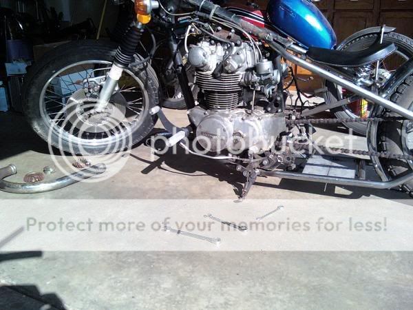

ok, i was waiting on some universal forward controls that i bought of ebay for 100bucs. I removed the front motor mount plates and welded tube to the plate and then a thivk wide washer to the end and drilled the proper hole to enter the bolt through to the controls to thread on to.
painted them rustolium semi flat black and installed them on the bike. here is what they look like.

now i can chop off and unbolt the stock foot pegs. Now i need to fab up some linkages for my controls.
I don’t know what you plan to do for the factory foot pegs…But I can tell you what I did when I ditched mine and how I made linkages.
I unbolted the foot pegs, and cit the pegs off the big fat round mounting point, and then used a bench grinder to make that smooth and round like a huge ass washer, and then bolted them back on…I’ll try to snap a pic of them when I run to the shop in a couple hours.
as for linkages, I turned the stock shifter straight down, and cut it in half. then I drilled a hole and tapped it, and used one of those “i”-hook deals where they are threaded into a bracket and one side is reverse threaded…and I took out the normal threaded i-hook and welded more threaded rod to it for desired lenght and then just used a bolt with a small nylon bushing to allow the i-hooks to move freely

i fabed up and made the linkage for my forward control gear shifter thingy.lol
works just as planned, just some grinding/cutting/welding like everything else. next ill tackle the rear breaks side of the project. hopefully tommorow.
