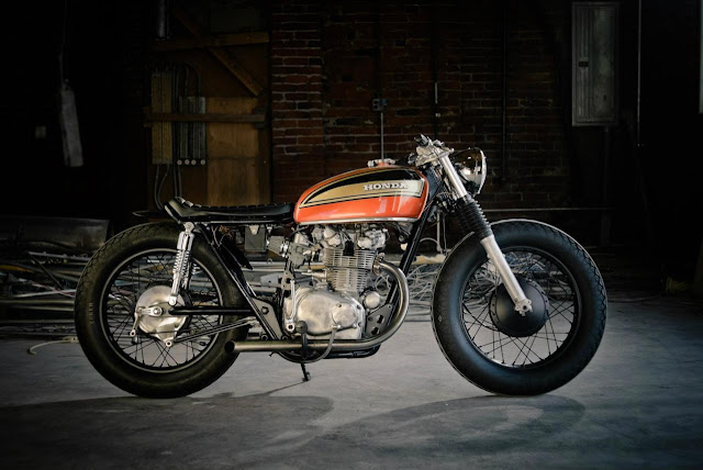

I kinda like this one:
http://modernmoto.net/wp-content/uploads/2011/03/honda-cb450.jpg

I really like this one.
