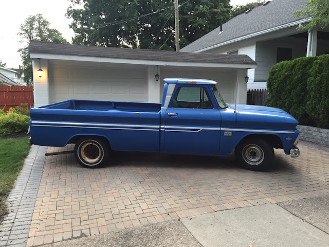

1 year ago bpipe and I went to Elmira and met Terry Ostrander, a wacky retired racer. Among his collection of roadkill cars was this '66 Chevy C10 long bed. The sheet metal was not good but it was a big back window deluxe cab truck that is a little tougher to find. And it was complete. He gave us day old cookies from his bakery and a bag of peaches from his produce store. Dude was incredible.
This truck was so shitty that we barely got it off the trailer and into the driveway. This is literally where it died.

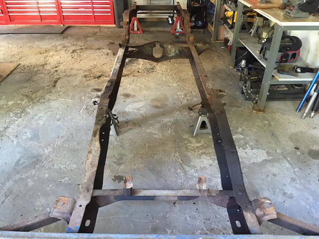

Pretty much got right to work tearing it down to the frame.

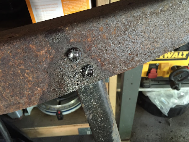

I drilled what felt like 1 million rivets.

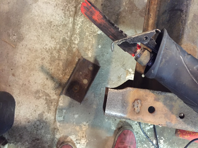

Then I cut a bunch of things.
What I did in the rear:

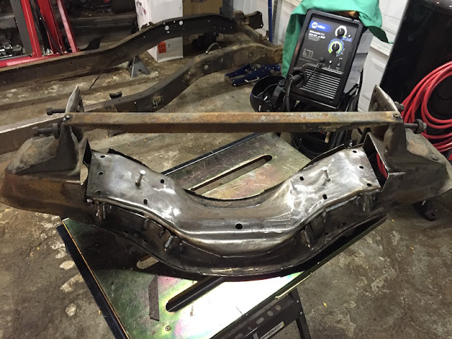

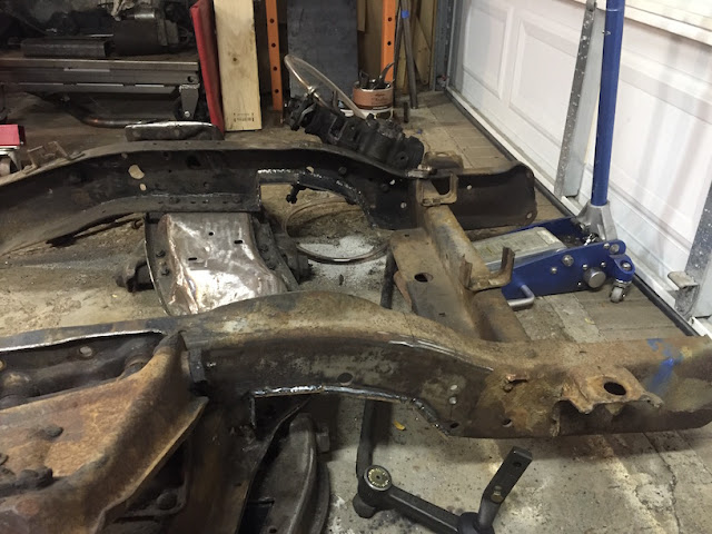

Added a big notch, custom panhard bar, bags on the trailing arms, moved everything back 1" so the wheels are centered in the wheel fender opening, notched/flattened the center crossmember.
What I did in the front:
I removed 2" from the front crossmember. This allows the truck to sit 2" lower in the front and keep the suspension sorta close to drivable and the engine
mounts in same spot, although I ended up raising the motor 1" anyways. The steering also needed to be raised 2" and forward 1", so a notch was cut for that:
Cut the long bed frame down to short bed specs

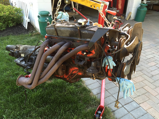

Then I cleaned up the turd small block

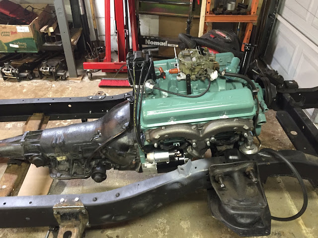

I spent a few weeks making it all nice. Then tried to start it and realized it was shitty. So I bought a 6.0 / 4L80e combo the next day.
Did the normal custom wiring harness stuff from lt1swap.com that everyone does.

Cut the longbed down. 12" in front of the wheel, 8" behind.
