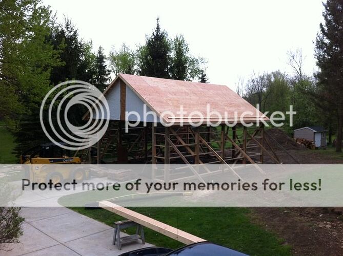

Here is an update from this morning.
X…
Looking good man :tup:
If nothing else at least install the tubing and manifold. Even if you dont use them for a few years, itll be ready.
Dan
I’d murder for radiant heat. I have a 125,000 BTU kerosene torpedo heater, but nothing compares to a 65* floor in January.
Progress looks great. I’m really jealous of that nice driveway you have.
Looking good, I need to change my oil hurry up and build that thing
Look into radiant tube heaters, 100x better than that 125k torpedo. They work really well and heat up everything.
Next DND will be spent doing nothing in your garage.
What did they do in the holes before the set the poles? Pour a small pad, toss a bag of sakrete and a block in, nothing?
Just curious.
Dan

Concrete 24" holes, 56" deep, and the poles go 48" in. (a 6x6 pole)

Here are a few updates from this morning.
This one you can really tell the attic trusses for storage, change over to the scissor trusses for the extra tall part of the ceiling. The garage door will hang from the attic truss part of course.
The walls are 10’3" from what will be finish floor, and the middle of the ceiling is 16’6, that should be enough to put all my lowriders on the lift. LOL
I am still trying to find the perfect solution for getting up to the attic. Pull down stairs are an option, but I’d like to have something better, I just can’t think of it right now. It would be cool to be able to use the lift to get large items up there, but I’d have to figure out a way to enclose that upper space for the winter because that won’t be heated space… or maybe I should just insulate the whole thing… IDK still working on that.
X…
