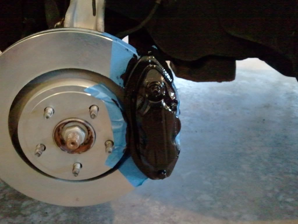

Well, the Jeep was in dire need of new brakes. Just bought it 2 weeks ago and the previous owner had left the stock rotors on for all 78k miles. ](*,) I went with R1 Concepts OEQ stock replacement rotors, zinc-coated, and Stoptech street/track pads. Ordered up a G2 caliper paint kit to repaint the Brembos since the paint and decals had all put peeled off some of the calipers. Member on Cherokeesrt8.com hooked me up with some new red Brembo stickers.

Bedded the brakes with ten 60 to 10-15 MPH stops and one 80-5 MPH stop and drove for a good 10 minutes to cool 'em down. (Read Instructions for bedding in your brakes for guidance on proper bedding). What a difference now! The way Brembo’s should feel. No squeaks, just lots of G-forces on hard stops.
Installing the new brakes took a couple hours on Friday night, never done Brembos before, but much easier to do than other cars.
Took me about 2 hours to prep and paint the Brembos. I taped them off, used 00 Steel wool, 320 grit sand paper and the G2 caliper cleaner, did three passes of sanding. Two coats of paint. Per the instructions, the G2 paint did bubble on the 1st coat, but the 2nd coat helped smooth it out. I’m very impressed with the product and there was enough paint to even do a 3rd coat if I had wanted to. The G2 instructions say to give the paint 24 hours to harden. So I bedded the brakes right around 24 hrs on the dot and the caliper paint and decals held up just fine to the heat.

How long is the vinyl going to last on those calipers?
I did NOT plastidip the calipers. That would be crazy. I used G2 http://www.g2usa.com/product/G2.html
Stuff is heat proof up to 900+ degrees and dries super hard and glossy.
