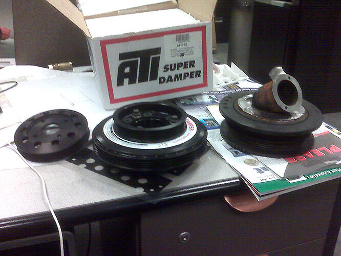

On the right is an example of why you cannot machine the third pulley (PS) off of an RB26 crank pulley. There was really no way of knowing that this would happen by visually inspecting the part…
The lesson learned is quantified by the 510 dollar ATI superdamper (center) and the accompanying waterpump pulley (to clear the larger damper). However, this is supposed to be an EXCELLENT addition to the motor, greatly increasing longevity, so it’s not all in vain.

sad to hear about a 500 dollar pulley, that money could have gone to a more useful part, there werent any cheaper alternatives?
It’s actually a very useful part.
It’s not just a pulley it’s a harmonic damper…

what happened to that pulley, I don’t understand the picture…

I tried machining off the PS pulley for more clearance, but apparantly the only thing holding the center hub to the outside damper assembly is the front pulley.
