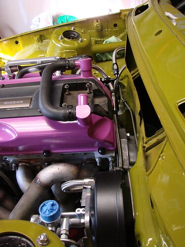

They don’t make a silicone aftermarket version of that hose on top of the engine? Maybe it’s just the picture but that looks like a regular rubber hose…i think silicone would add to the gloss bling factor of your bay…and obviously be more durable/last longer.
It is regular rubber hose. I should have welded on AN ports. I’m unaware of any aftermarket parts.
That is a stock hose i assume right? you’d think that for all cars/motors, THIS one would have silicone aftermarket versions of EVERY rubber hose.
Meh, at least it’s in a super easy spot to get to if it ever does wear out…i’m just so use to every hose being a pain in the dick to get to, so any time i had something apart, any hoses i exposed were replaced with silicone.
Actually Samco makes one, 150 bucks. I might be changing the breather setup in the future anyway, so IDK if it’s prudent to purchase it.
I honestly don’t see the point in a breather hose being silicone.

Where are you getting your Stainless lines, or do you a means to make them? You must have tons of time into finding/routing/making/re-fitting in that engine bay.
Actually I have not made more than one line once.
I buy the hoses and fittings from summit, then assemble them myself.
Only tools you need are a cut off wheel, tape, grease, a vice and wrenches (i use a crescent wrench wrapped in tape to avoid marking the fittings).
I probably have nearly 500 bucks in stainless lines and fittings on the car tho!

Not to sound noobish, but do you use the cutoff wheel for braided stainless line? How clean of cuts does that make? I know that the line frays no matter what you use but I bought the Cutting tool that summit sells and I have never been impressed by the quality of cuts it makes after I remove the tape.
^FYI…I have used a fine tooth (32 Teeth/inch) hacksaw and electrical tape with VERY good results. I have heard an abrasive cutoff wheel works well too provided you take your time and not blow through the hose in 2 seconds.
