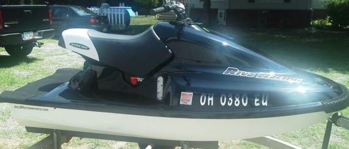

If it’s not fiberglass i’d just blast it with some primer and paint and have at it then.
That said it looks like it’s had a pretty rough life so buy it knowing something could go at any time.

I’m not going to quote the above, you CAN visually inspect the impeller. Basically you want to look for any pitting/dings/bends/etc… It should look smooth and the edges should look sharp. Any little knick or bend can affect performance. If the damage on the hull is not from being beached, then it may be in good shape.

See this. Typically you can visually inspect the impeller. You can always hook it up to a water hose as well, however this will not tell you if the impeller is good or bad, only if you have leaks or other problems with the engine that may not be apparent by a visual inspection. After purchasing one of these in the past and looking at a few others… I don’t think I would ever buy a PWC unless I had it in the water for a true test.
From what I am reading, these hulls are painted, not gelcoated. However, getting polyurethane to stick would be tricky at best. I think the advice that I gave with the Epoxy Sealer is sound advice. The advice that I saw is that Poly won’t adhere to it well, but Epoxy will (this stuff will adhere to more-or-less anything, it’s insane). You can follow that up with Brightside polyurethane paint over the Epoxy Primer, http://www.jamestowndistributors.com/userportal/show_product.do?pid=64&engine=adwords&keyword=brightside_paint&gclid=CNS1z5Hl9r0CFRQV7AodRz4A2g . I’ve used that stuff on multiple boat hulls before and it comes out GREAT. Also comes in a variety of colors.
In the end, you’ll be into it for a couple hundred, but the repair should look great.
@boardjnky4 yeah the hull is SMC and I’ve read to do it properly you need something like this: http://www.evercoat.com/productDetail.aspx?pID=16
The paint is urethane.

That’s a resin, not a paint. That’s not going to be your final finishing coat. That is intended for re-inforcing, adding strength and filling cracks. Think of that as the body filler/“bondo” of this repair. After that, you will still want to prime and paint the surface. That’s where the Epoxy Sealer and Poly paint come in.
Ah, gotcha. Your link said it included a resin as well though, maybe I just read it wrong.

I’d pass on it.

Waiting for @boardjnky4 to comment on the impeller. I’ve found new stock ones for $100.
Click HERE for a quick start up video. Yes, I know it’s bad to run them for long outside of water and it wasn’t. I just asked him to send me a quick proof of life.
