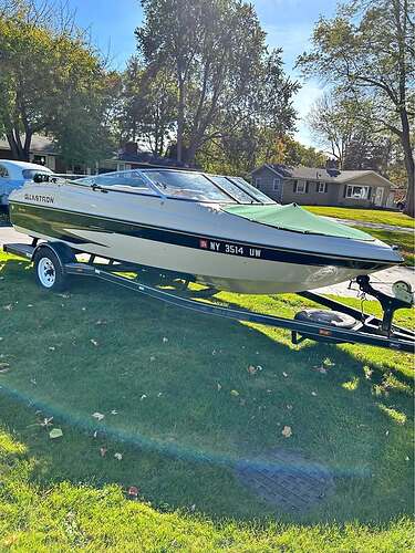

That Regal looks promising. I’m guessing it’s the 5.0 carb, so 220HP. That’s enough for a 21, probably good for low to mid 40’s top end, maybe upper 40’s with the right prop. Looks like it was never stored in the water which is a huge plus.
If you do the basic work yourself, and you buy a boat that has been taken care of the expenses really aren’t bad, assuming you don’t want to store it in the water at a slip. If you’re going to slip it expect to spend a lot in maintenance because it’s just much harder on a boat if it sits in the water. Expect to get killed in maintenance if the boat has been abused.
