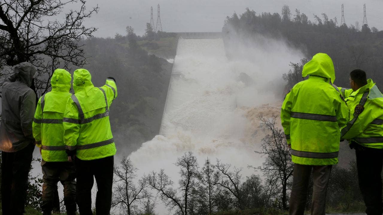

I have been following this. Why does the damaged main spillway prevent it from being used, though?
I’ve been wondering the same thing. I think their concern is it’s also eroding uphill and if it compromises the control gates they’ll then have no way to control it.
The damage is REALLY far uphill though. It sounds like it is being throttled, so I don’t think it’s a capacity issue. Maybe they are worried that it will fail closer to the dam as well.
http://www.gannett-cdn.com/-mm-/e88b63e0a25412af1392c2694944ee3885c4314f/c=28-0-936-683&r=x408&c=540x405/local/-/media/2017/02/08/Redding/Redding/636221852895186113-dam9.jpg
VS
http://fm.cnbc.com/applications/cnbc.com/resources/img/editorial/2017/02/10/104275309-OrovilleDam_spillway_damage_Feb2017-b.530x298.JPG?v=1486750457
In the 2nd image notice how much worse the damage is on the right side, and more importantly, how the hillside on the left has started to erode as well. I’m no geologist but my guess is they’re concerned if they keep using it, at least at the level they needed to prevent the water from reaching the emergency spillway, the whole hillside will give way and they’ll lose the control gate.

I think that image confirms my theory as to why. It’s so much water and eroding so much at the damage point that i they keep using it before long the whole hillside would fail taking the control gate with it.
Sounds like they almost have it under control right now with no water coming down the emergency spillway and the main spillway dumping 100k cubic feet per second. Hopefully they can figure out a way to shore up the emergency spillway before the rains Wednesday.

Yeah, they’ve cleaned up some of the terminology being used now. The press (as usual) is getting all kinds of stuff wrong. The key things you need to understand are.
1: The concrete slide looking thing with the giant crater in it is the “Main Spillway”. This morning they were calling it the emergency spillway.
2: The dirt to the left of it (in the pictures with the lake behind it), with the concrete lip, is the “Emergency Spillway”, or the proper term for it, “Auxilary Spillway”. That’s the one that has never been used since the dam was built and the one they were sued in 2005 because someone had the foresight to say, “Hey, if water ever did spill over this thing it would just wash away the dirt and before very long the concrete lip would wash away, all the water would come crashing through, and everyone drowns”.
I thought when they said this morning that they had stopped the water on the emergency spillway they mean the concrete structure, which would be good because they could repair it or at a minimum the erosion would be stopped. That’s not the case Water is still blasting into that crater at 100k cu/ft per second, the rate they had to increase it to from 55k in order to stop the water from continuing to overflow the auxiliary spillway. They had decreased it from 100k to 55k because they were concerned the erosion happening to the concrete was going to cause THAT spillway to fail.
