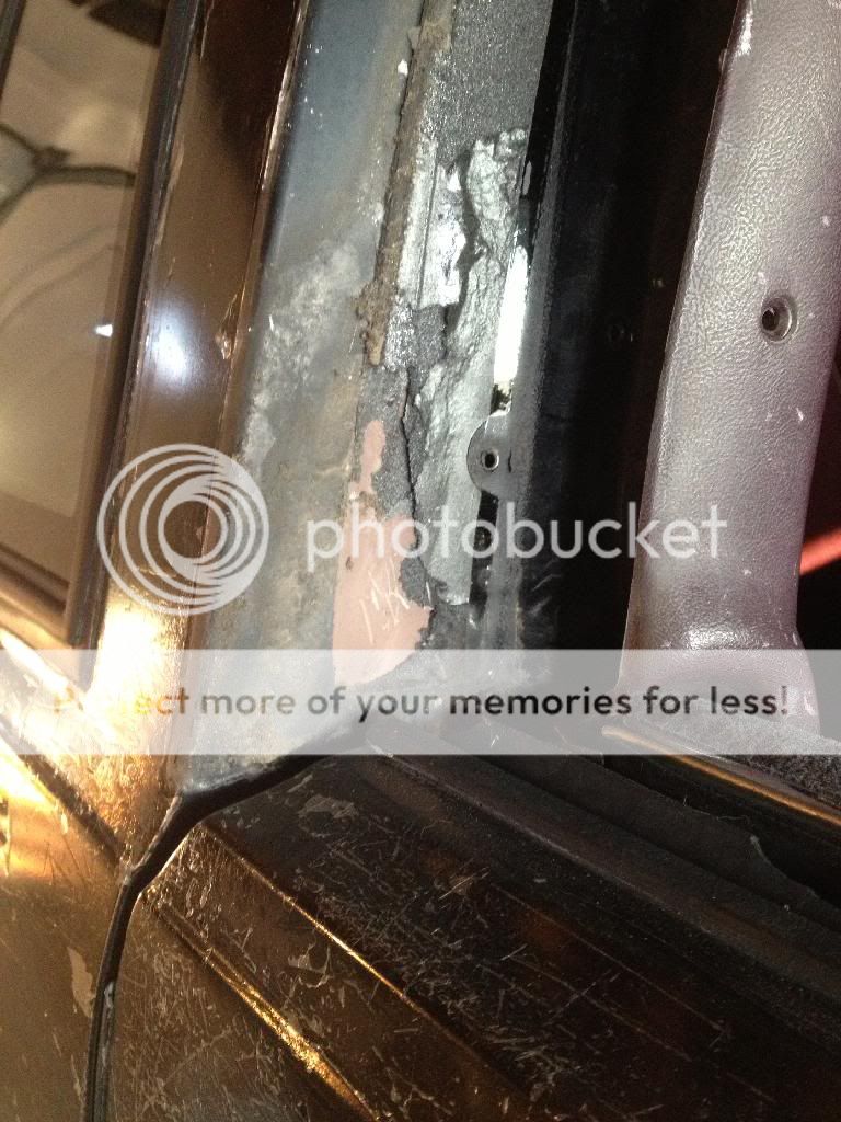

The guy did put filler on a couple areas on the door, he did a terrible job he put it on kinda thick, so I think I would need 80 for that, but I also had the car outside in the weather since I owned it in its current condition, so I think the filler might need to be stripped off? Does it go bad if it gets wet?
The car is garaged now since we closed on our house, but I just want to make sure what I can do.
Filler exposed to the weather = bad! IMO, I’d remove it then go from there, especially if it’s thick like you’re saying.
this. moisture in body filler will only ruin anything you cover it with once the sun heats it and it shrinks up. 320 will be aggressive enough to get the flaking clear off and the surface flat yet gentle enough that 3 passes won’t put you to bear metal. if you have high body filler, sure 80grit is useful, but ONLY use that heavy of a grit on high filler and work your way up in grit count towards 400 to paint.

that looks like body filler, but looking at the paint that’s on the door you will have to strip the whole car. The paint has bad checking and the only way to get rid of it is to strip the car to bare metal. You can do it chemicaly with air craft stripper or with a da and paper. Air craft stripper is very messy and stinks but its a lot faster than sanding it off.
Agreed… that paint is BAD!!!
Depending on the car, and your goals/budget, I’d almost suggest gutting it and having it blasted…
