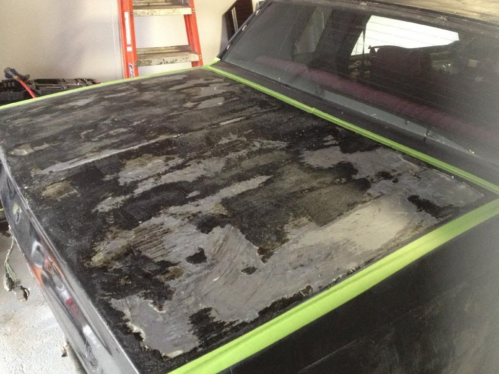

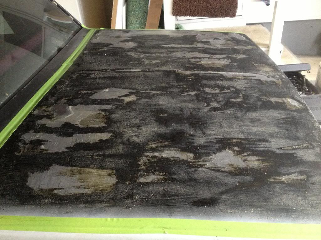

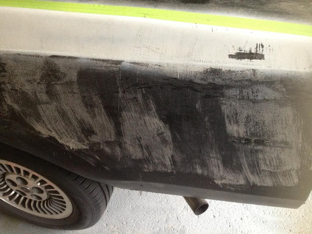

Pics!

I did the trunk 3 times with the aircraft stripper, the quarters only once because I soon learned it seems to work like shit or I’m doing it wrong but following the directions.
Did you get actual aircraft stripper or the 15 min Klean brand paint stripper from lowes/HD?
I got it from advance auto. I don’t know the brand but it says aircraft stripper on it.
I have found when you use the air craft stripper if you put it on and just watch for to paint to start to wrinkle, then watch for it to stop wrinkling then scrape it right away. If you wait to long it doesn’t scrape off easy. Also when you see you are down to the primer take a steel wool pad and soak it in lacquer thinner and scrub away. it will take you down to bare metal fast. The air craft stripper doesn’t cut the primer as well as the thinner does. And yes it takes awhile to do either chemical or mechanical. I found for me it was a lot cheaper to chemically strip them. Body work isn’t any fun to do, that’s why shops get big bucks to do it. There is a lot of labor involved.
My friend said I should have left it on for longer like 30-45min but I agree with you it seemed like it drys up and doesn’t come off easy at all. I don’t know if there are other chemicals out there that would do a better job.
