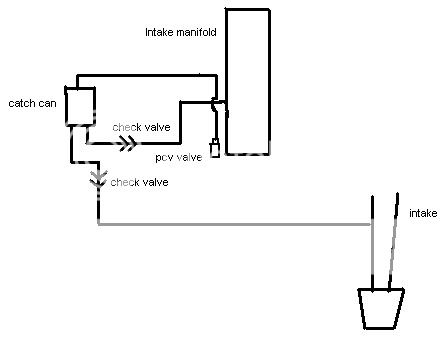

The holes for the pcv piping should not be plugged. The stock pcv system needs to be redone when boosting the ka, the pcv valve would close under boost and there would be no way of releasing blow-by gasses. The easiest way to avoid this is to have a catch can with 1 inlet (pcv valve) and 2 outlets, one hose to intake manifold and another hose to the turbo inlet pipe with a couple check valves. This way when you hit boost the pcv valve is still open and venting to the turbo inlet and under vacuum the intake manifold is taking the blow-by gases from the pcv valve. Heres a diagram of how my ka-t is setup.
http://i536.photobucket.com/albums/ff324/marty905/pcv2.jpg
