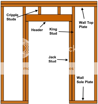

for those who are oblivious to what the inside of walls look like:
http://img.photobucket.com/albums/v348/BigEd2006/doorframe.png
They may say it’s “required” but like I said last night, there is no way they would design this thing to rely on DOOR MOLDINGS that are fastened by FINISHING NAILS. That would be retarded.
Your weight isn’t transferred to the molding. Even a 100lb girl hanging on molding with finishing nails would rip the mofo off the wall. The molding merely acts as an anchor to keep the bar stationary. The bodyweight is transferred to the studs framing the doorway.

Lol. Trust me. Carnut gets a lot more then most of the people on this site. You need this above all :
Now most home doors are made this was but if the door is a slider or some other unusual setup this bar may not work since there is not enough strength to support it.
So yes it does make sense.

ive framed houses, i know how to construct a doorframe,but thanks for the diagram
i was refering to don saying “I HAVE A DOORFRAME” and then willybeen saying “Finally, someone who understands!” or whatever… willybeen wanted someone to say they need TRIM around the door, and carnut said doorframe
