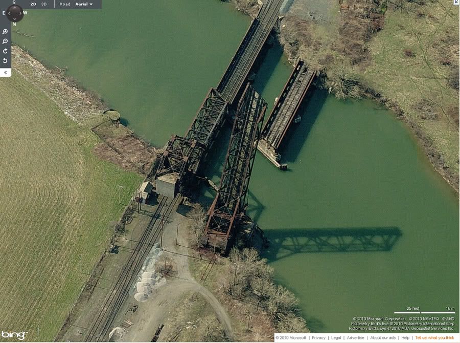

The task: climb and rappel the permanently raised drawbridge off the 190…
I scouted it a few days ago with IanK and Evolution VIII MR… it looked daunting. From a distance it doesn’t look that high… once you’re under it… it’s insane… it’s so so tall…
However, the climb itself looked fairly straightforward… the bridge is canted at a 75-80 degree angle off the horizontal, and the railroad ties it’s made of essentially form a ladder all the way up… a 180 foot long ladder… there was no way in hell I was going to freeclimb that… no way…

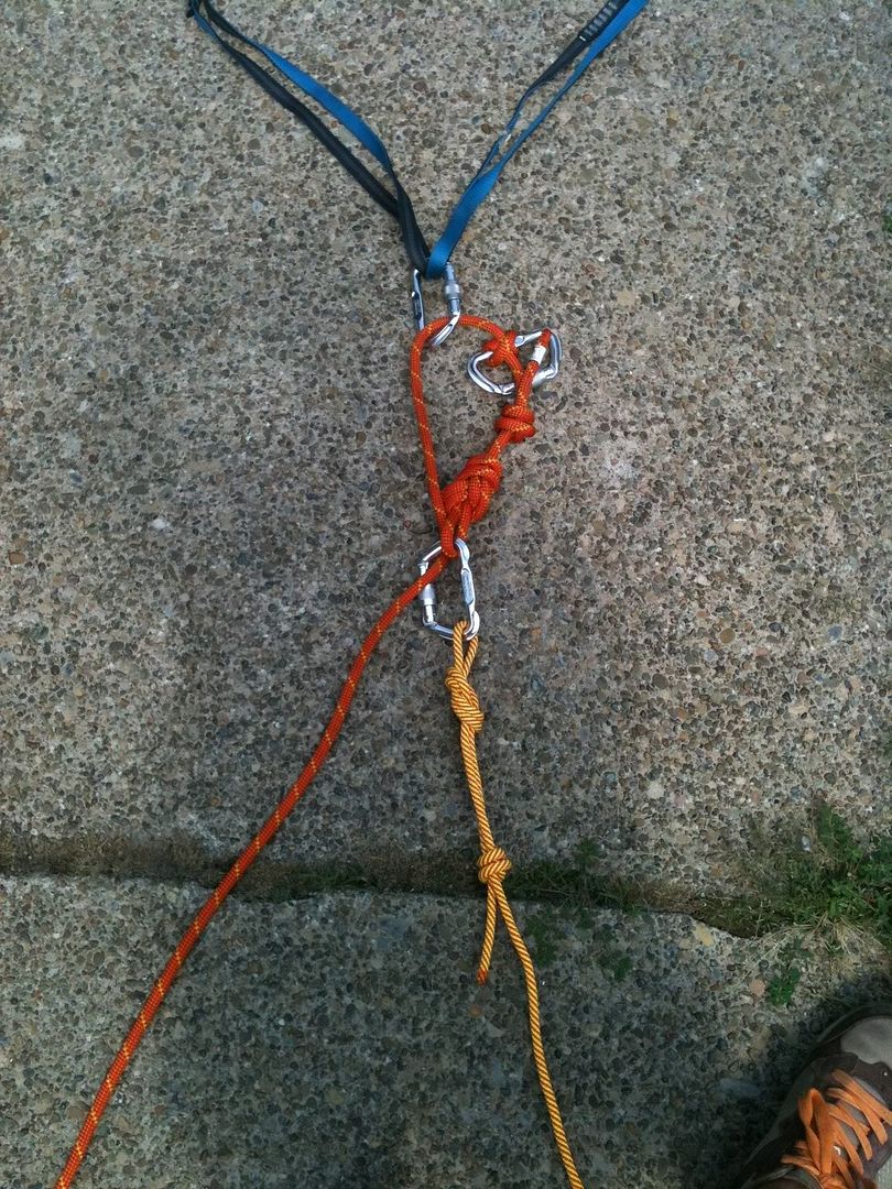

An anchor for the static line would be created with another length of chain and a rapide, and a special series of knots would be used to secure the static line in the anchor. The reason for this is so when the last rappeller is on the ground, the rope can be pulled down, leaving only the chain and rapide at the top (about 10 dollars worth of stuff).
I’ll explain that setup now. This setup is called a “reinforced 'biner block”
***In this picture, imagine that the blue sling is chain, and the very top-most carabiner is actually a rapide/quick link ( a LOT smaller of an opening than the 'biner)
The first knot used is a “clove hitch”. It’s tied to the spine of the biner that’s second from the top. Essentially, what you’re doing is creating a stop for the rope that’s too big to fit through the rapide… this is what actually supports your entire weight during the rappel. It basically prevents the rope from moving one way (the weighted side) and allows the rope to go the other way (the pull side). Since it’s not really a total “lock” and more of a slip joint it’s important to MAKE it a lock, this is where the reinforcemen comes into play.
Tying a figure 8 on a bight, and backing it up with a double fisherman’s knot a loop is formed. In this loop a carabiner is attached (the lowermost 'biner in the pic)… it then is clipped around the weighted side of the rappel line… In the event that the 'biner block slipped through the rapide, the load is then transfered to the loop formed by clipping the 'biner on the line.
Lastly, the 5mm “pull cord” is attached to the lowermost 'biner. Once the last rappeler is off the line, you pull the 5mm cord, which pulls the rappel rope all the way back up through the rapide, and eventually back to the ground. This would be my first time using this setup.

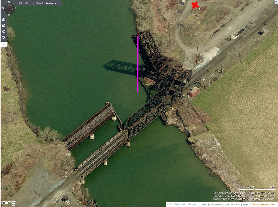

The rappel would be a free rappel… the pink line:

Then a cop showed up.
However, he immediately turned around and parked… (at the red X in the above pic). Then he didn’t get out of his car… it crossed my mind that he was waiting for backup to arrive or something… none came… It was then apparent that he was just parked back there to sleep… or smoke… or jerk off… HE DIDN’T SEE ME! I remained still for about 45 minutes… I could see him in the car with his arm out the window. He stayed parked there for about 30-45 minutes, while I stood at the very top of the bridge (I was clipped into a safety sling as well as still being “on belay”)…
