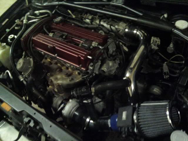

http://i150.photobucket.com/albums/s107/boostinspyder/new.jpg
Finished bolting up the turbo/mani/o2/downpipe. All the ic pipes, intake and the dv are on (I need to order a couple more clamps and a reduced coupler for the licp).
Other than that, I just have to drop the radiator/slim fan into the car and thats about it. Then its off to installing some Kelford 272’s, springs and retainers and a better clutch.
Lol leave all that shit out. You’re gonna have to take most of the stuff that you just put back in out again to do the clutch.
had to make sure everything went in well
Ya, good point. You should get that polished cover for the manifold that Paul had when he had the cast 35r kit. Makes it look nice!
I think my wastegate may be in a different place than pauls was. I dont know if that cover will fit. Plus for now I just want to make sure everything goes well mechanically first lol
Haha just looked at it, don’t think that cover would fit. What are you aiming for on e85 with this? Like 500+ I would assume right? Also what injectors you going with and did you get some sort of ignition amplifier?
e85 yes, im have rc 1000’s in the car. Nothing for ignition and as for hp Im not sure Im hoping to hit 500 at least, if I dont run out of fuel by then lol. well see though
