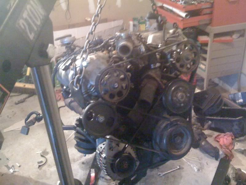

HAHAH yeah, dont worry I am replacing it, going to pick up all new hoses today…that was one hose i figured i should do i dident realize till i took the picture that it was on there, I thought i cut all the hoses off
Nothing really new, put the motor on the hoist…
Got the belts on, everything is pretty much on so I can drop it in… just gotta clean the engine bay…

Umm so yeah, after a few henikens i got myself motivated and decided to give throwing the engine in myself a shot…
And TA DA
Dident think it was going to go in as easy as it did considering i dident take the transmission out, but it took me about 45 minutes, 10 or so of that was adjusting the crane after realizing that the arms wasnt long enough.
Now I just gotta bolt the tranny/starter back up, finishing hooking up the harness, bolt the turbo and oil return/feed lines… a few hoses, fill her up , and give her a test fire…

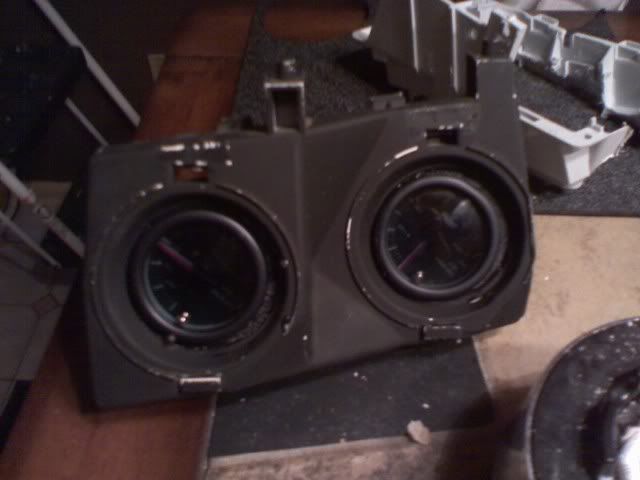

Then tommorow I’m going to modify my stock dash cluster for the aftermarket gauges and get the wires run and ready to go.
At 12am last night I got motivated and said I need to get these damn gauges mounted in the pod… So last night I borrowed petes dremel and went to work. It’s not perfect but itll do for now
was that the part that held the compass thing and that other guage? in the center of the dash?
No compass on my model… only the 84-86 digitals came with those gay things…
it was Oil Pressure and Voltage
Now Boost and Oil Pressure
ya, i get your and chris car mixed up.
that and 2+2 and non 2+2… gay.
Looks good none the less. Call/text if you need a drinking /dropping the tranny on your hand buddy.

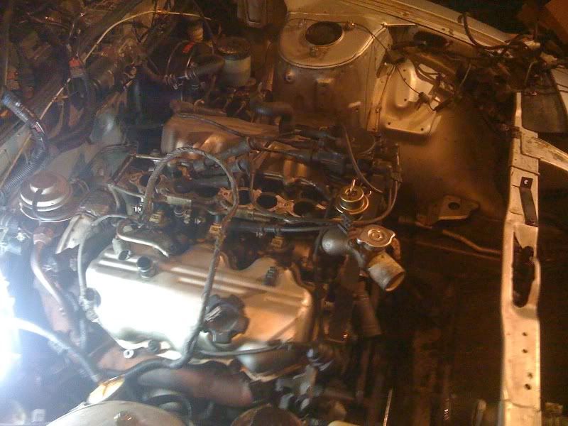

So I got her running tonight at 11:30…
Had some issues at first, I had the CAS plugged into the wrong plug :rofl
so then we got spark and fuel then it became a timing issue.
Finaly she got running, but like a bag of shit due to the lack of idle control valve and it being 20 degrees out.
So tommorow when i get hoem from work were going to get the timing set good, im going to tidy up all the flailing wires start her up, get her running and warm, keep checking for leaks… check some more for leaks and then take her for a test drive
video clips to come tommorow hopefully
im so fuckin stoked, she sounds sooo nice
Nice man, why won’t you install the idle control valve, won’t it stall on deceleration sometimes?
Depends, I need to set the idle a bit high now because of the cams… AS long as the motor is warmed up it shouldent stall, it will be a cocksucker when its cold thou…
I guess itll keep me from beating on it before its warmed up haha…
But not it shouldent stall under deaccel
