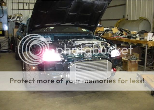

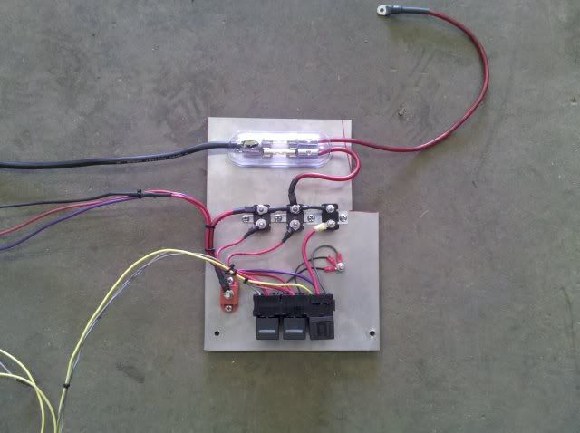

Got the relays wired up and made sure both fuel pumps are working. I’m going to get some gas in the tank and check the system for leaks. Also got the fan wired up and the headlights going. Something strange is going on, the blinkers blink when the lights are off but not when they are on? 4 ways work, high beam, low beam, markers all work. I haven’t checked the break lights yet. I didn’t install the dome light nor did I install the door switches so I’m not sure yet what that might cause?
When I turn the key to “on” there is no beeping, I don’t know what the beeping was before but its not beeping anymore? Probably seatbelt off, door open or lights on with car off?
The SRS light is on, there is nothing left of that system so should I just leave that plug out of the cluster or take the bulb out?
Debating on hooking up the reveres lights and a horn. Could hook them up with the same momentary switch? That would kill two birds right… for inspection.
I should be able to dump some oil in it and fire it up… just need to install the oil pressure gauge first.

9/10 times weird issues like that are caused by a ground or seven not hooked up.
and yes, hook reverse and horn up correctly, you never know.
Dumped some fuel in it, turned on the pumps… wow no leaks!
Haven’t gotten the hood to latch yet, its making me crazy
Usually when you have the keys in the car with the engine off and you open the door, the beeping turns on. So when the door opens, the door switch grounds the beeper. Thats how it is on my crx, idk if its the same for your car but i would imagine so.
So the beeping is telling you not to forget the key… might have to hook the one door switch back up. Thanks

yes, the only other thing i can think of is the stock seat belt sets off the beeping while the car is on and someone takes their seatbelt off. but you more than likely arnt running stock belts with seats and the wire that plugs into the seats haha
