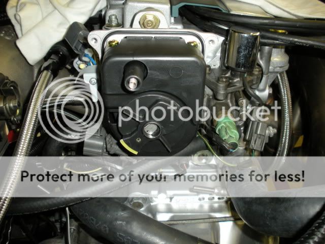

Car won’t start? Loaded a stock p72 map with Crome and my Ostrich and have 240cc injectors installed. Starter is running fine, sounds strong and volts are right up at 14. Fuel pressure is 90psi, I checked spark, I have 10psi of oil pressure while cranking (which I know doesn’t effect it starting). I pulled the number 1 and 3 spark plugs and don’t smell fuel. I am thinking my injectors aren’t opening. So I checked voltage at the injector plug which did say I had a signal. What do you guys think? Next step after consulting NYspeed is to install the 1000cc injectors and see what happens??
I also tried rotating the distributor a few degrees in both directions. I have another ECU so maybe I will swap that before I swap injectors…
Still need ideas!
