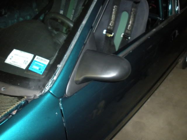

no passenger mirror ftl
Mirrors vibrate so much with the solid mounts it don’t much matter having any.
i dont have one on my accord, it was like that bone stock y0
