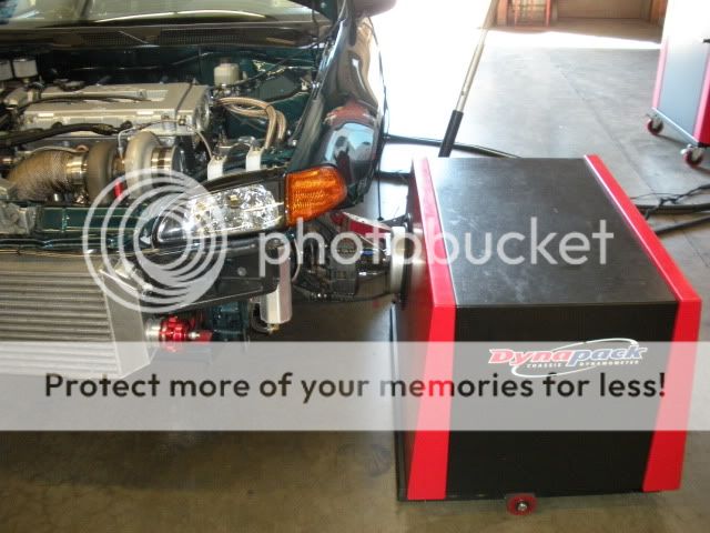

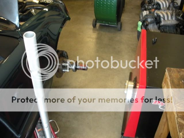

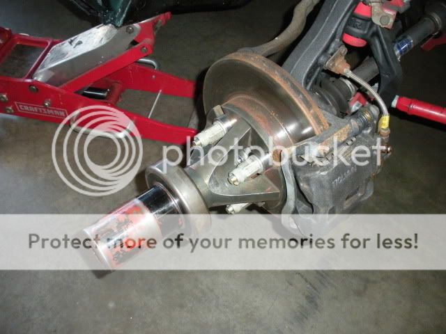

Well here are some pix, took them might as well post them
looks awesome, John said you were a cool dude and the car was really nice
