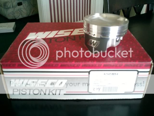

nope, no hg options except GE ls/vtec 84mm

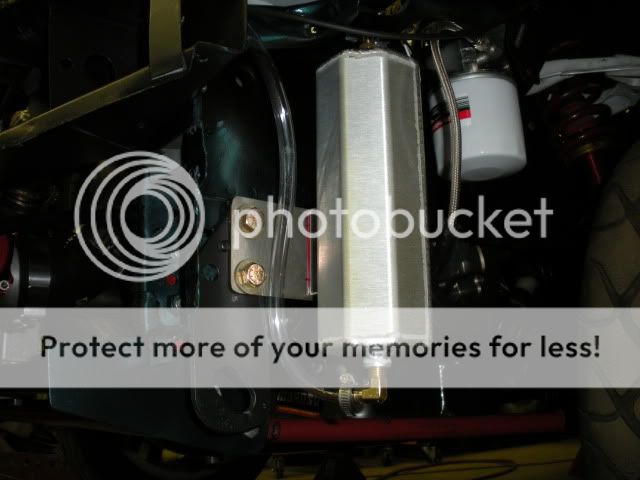

Is the oil filter relocation kit new this year?

  2. Depending on the type of assembly lube he used you could have had issues from how long you were cranking it and the oil filter relocation in respects to priming. Oil is picked up at the pump, sent down the main galley first then through the filter where it enters the main galley for the crank… You have it trying to pump all the way through the oil lines and filter. It is possible that you did not fill enough oil or that you could have had dirt or debris in the lines. The scoring on the bearings indicate dirt from assembly. Did you blow or clean out the lines before you installed them? If not this could be a huge part of your problem. I would check the crank oil galley holes no doubt they will be packed full of metal but check for signs of black rubber which could have restricted oil flow to begin with.

I did crank the shit out of this thing trying to get it to start, and yea there was no way to keep this as clean as I would have liked in the shop I am in. I honestly cant remember cleaning out or blowing out the oil lines for the cooler/ relocation… so there could have been crap in there. The kit was on there last year so its not new. I will bring the oil pump with me for inspection and I will make sure he has the new pump for reassembly!!
