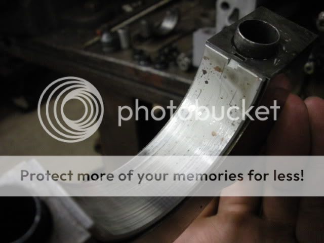

umm wait a minute. You have a pic showing a solid bearing in your main cap. Do all of your main caps have solid bearings in them? Both upper and lower? IF your crank has crossdrilled main journals you can run one half fully grooved and one half solid bearing, if not, you need fully grooved main bearings top and bottom for every main. The oil that lubes the rod bearings comes from the main bearing journals, thats why they are fully grooved. If you didnt have fully grooved main bearings your going to have rod bearing oil starvation issues, which I think is whats going on here
Ok so both of the two main caps that I pulled off were solid bearings, I don’t know what the tops are. Also the two sets of rod bearing I removed both looked to be solid, should they be? I was trying to find a detailed description of how the crank lube system works but haven’t found one yet. Im pretty sure the GSR crank is crossed drilled so the rods should be getting their oil from the mains thru the crank.
Correct me if I’m wrong, Oil is sent from the pump thru the block into the top of the mains and the hole that should be in the top main bearing lets oil into the crank which then sends oil thru the crank and into the rods? So if the top main bearings don’t have the hole and grove the rods wont get oil?
You are correct. Youd have to pull the other bearing half to see if it had the oil groove in it. Im sure it does, it would be a huge noob mistake not to.
The main caps (bottom) do not have the groove, the top (block) half of the bearing should.
If the rods were installed backwards that’d cause oil problems too. Eagle rods are directional.
Yea it would be a mistake but it would also explain what happened. We did go over size on the bearings so I think its possible that the wrong ones could have been installed. I will have to contact the builder again. Should the rod bearings have a grove also? Now say the builder did install the wrong ones would it be safe to hold him responsible for this? The question I am asking myself is how did it hold up for 6, 8, 10 pulls before we noticed… would that be possible?
Can you explain, What makes them directional?
The tangs should all be on the exhaust side, putting the oiling holes on the intake side.
what oiling holes?
Rod bearings should be solid, yes. Afaik, Each rod bearing gets its oil supply from an adjacent main bearing on a honda, normally there is only one oil hole in each main bearing journal and only one hole in each rod bearing journal on the crank, so even if you have a fully grooved main bearing in the upper bearing half, unless the crank was cross drilled so that one of the oil holes was feeding the crank and rod bearing all the time, you have a recipe for disaster, because the rod bearings would be, in effect, be getting half the oil they needed. I can only guess that the upper bearing half is fully grooved, but even if it is, unless the crank is cross drilled so there are 2 oil holes per main journal feeding the rod journal, youll have problems. If the upper half of the bearing is grooved, AND the crank is cross drilled, then this should not be an issue. There are also oil holes in the rod itself, that squirt oil at the underside of the piston to lube everything, and these need to be installed so the hole is on the intake side of the engine.
Edit: All stock hondas use fully grooved upper and lower halfs in the main bearing area.
Going to check this out personally on Sunday. It’s a GSR crank and I know it is cross drilled. I have a feeling everything will be as it should be. Then I’ll be back to figuring out what happened still.
What temp would oil start failing? Other then the oil pump failing what could cause oil starvation to the rods?

I took the crank out at the machinists shop and nothing else looked out of the ordinary. The upper main bearings were grooved and had the holes. The crank was crossed drilled and clear of debri. Still calling it oil starvation but don’t know if its from to much temp or to less pressure. I will run the oil cooler and am thinking about trying a 20-50 oil… what do you guys think of that? Or maybe a synthetic would hold the wedge better?
just run 5w30, i really think your problem was the cut crank
