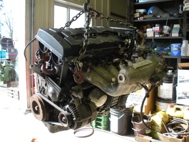

Picked up this OBD0 LS for cheap. Not sure why or what for but… well here it is!

These guys looked as if theyd never seen a B-series before
