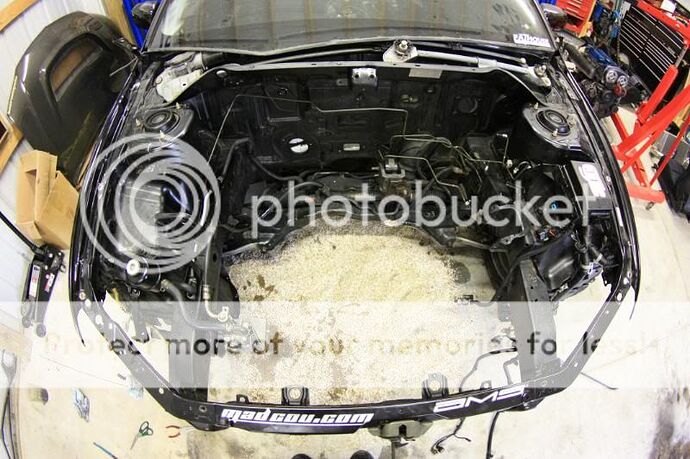

Anyone know if there are different power steering set ups between the different Evos?
This guys car doesn’t seem to have those cooler lines?
His car looks like it’s missing lots of stuff like abs etc in that pic. I’d guess he just took off the lines you’re having problems with?
Yea he is getting ready to strip the bay for paint. I’m just wondering if his car is a RS and/or if there are different P/S set ups. You can see in the pic that its a complete circuit…

I think I just need to hook 16 into 12 and remove 17, 19 and 25
