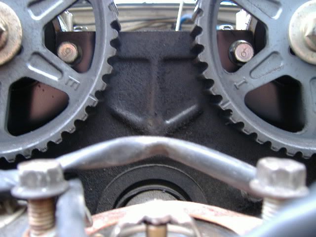

So I limped it into my driveway a few days later, and started tearing it apart. What I found was interesting. The crank pulley lined up with the zero mark when cyl 1 was at TDC. This mean my crank was fine
Upon further investigation, I found this:
This is with the crank at TDC. Note the right cam mark “I” is a bit below the point on the back plate. My exhaust cam jumped a tooth! So after repeated attempts to get the timing right, I finally got it. A tutorial on Miata.net warned that it is a PITA to get right, but I eventually got it. I Put the intake parts back in place and started it for about 15 seconds. It ran quite a bit better, but not perfect yet.

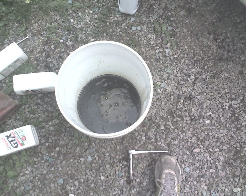

The first time I drained the coolant, it looked like this:
I flushed it a few times, but I don’t know if I got all of the nasty brown stuff out of it, or if oil in getting in the coolant. I am hoping it is just still a little dirty.
