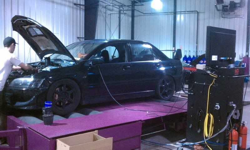

Upon arrival Emery greeted me. He seemed pretty eager to get to work. We loaded the car onto the dyno and played with the software a bit.
But then the nightmares ensued. Mind you, my car has been doing this for over a few weeks now. We thought we could iron them out on the dyno but it ended up being a large adventure. In third gear, at WOT the car cuts out at about 6psi at 3300 rpm. Consistently.
We played around with the tuning, tried 3 different roms. 2 MAF’s. Fixed some ground wires. Eventually we got the car to dyno a few times.
During the tuning we decided to play around with the injectors a bit more to get them as close as possible. Emery would not quit until the car was 100% perfect. On the last pull we got things almost perfect when disaster struck. The cutting out problem occurred again.
Either way, we made 310ft/lbs at 3,000 rpm @ 25psi, with low timing and running rich.

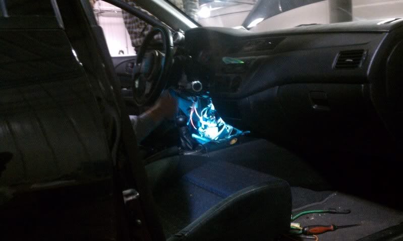

As the day rolled on, (we worked from 3-10pm, non stop) we noticed something strange. There was definitely a bad electrical problem, when emery would hit the brakes, the radio would light up and stay lit up. While lit up, the car would cut out. While off, the car would pull fine.

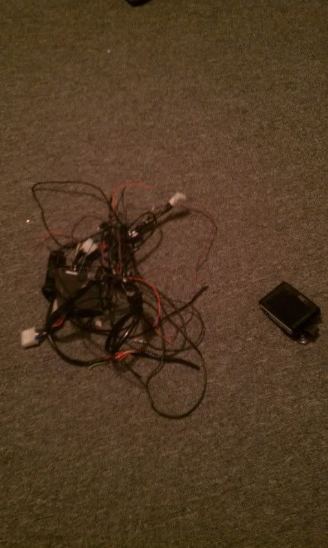

Emery immediately got underneath the dash and began ripping wiring out. A majority of things installed were not done so professionally. There was also some bad corrosion on the connector pins to the fuse block.
