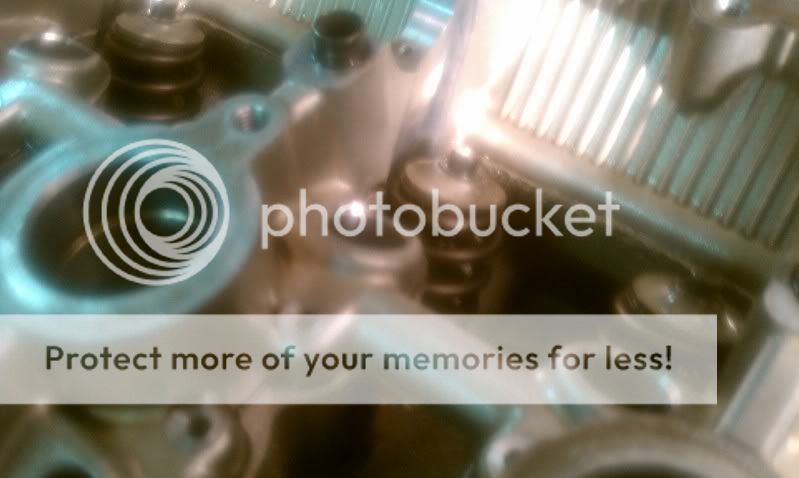

i have this tool for the valvetrain, it is AWESOME
http://www.euroexportinc.com/store/tools/mitsubishi-4g63-valve-spring-compressor.html

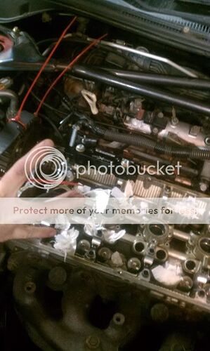

i also did it with the head on, make sure you plug up all your oil passages in the head. i made my own threaded tube to connect my compressor to keep my cylinder pressurized. i used 85-90 psi and it worked like a charm… only pull the spark plug you are working on and leave the rest in, chuck the wheels and put the car in 5th gear so it doesnt move, rather be safe than sorry right? i dunno if you know this all already, but there it is if you need it.
i have the timing belt tool, let me know
PS: have fun putting the keepers back in, they are an absolute PITA :lol:

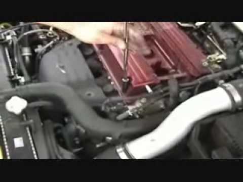

RRE has a nice vid on the install.

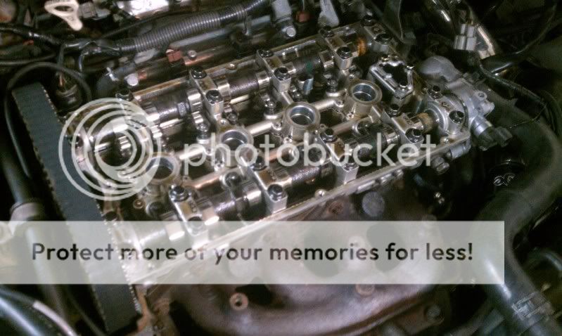

Decided to do my cams last minute yesterday after visiting STM.

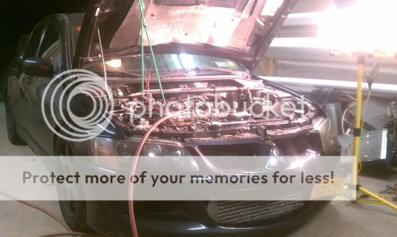

Called up some people, met at a garage and began wrenching. The job took about 4 hours, including learning how to use the valve tool and get the retainers to sit.

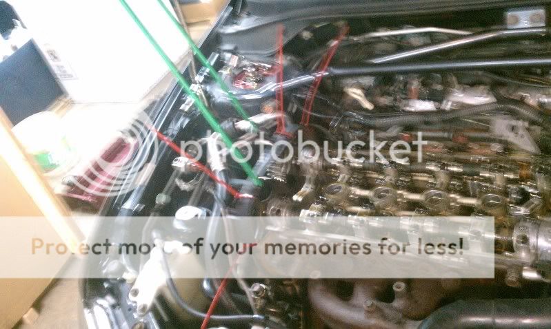

We ripped all the excess BS off, put the car in gear and got the engine to TDC.
Then we ziptied the cam gears and bungee corded them to the top of the hood.
Then we put everything back together in reverse order. I bled the lifters, and torqued everything down properly.
We put everything back together, released the belt tension and rocked the car back and forth to regain some belt tension. The timing was still perfect.
Started it up and finished the lifter bleeding process, took probably 4 cycles.
End result: Very lopey idle! Strangely they idle better than my BC cams on the BC tune. The driveability remained the same, if not better. Can’t wait to dial these in and dyno it.
