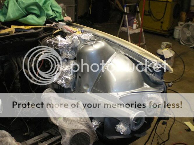

watch that windshield man, you’ll have pits in it like crazy. are you welding the shock towers or something?

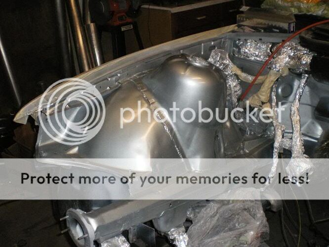

after grinding the seam sealer off i decided to throw some stitches in the shock tower before i sand/prime/paint. im not going anywhere near the windsheild right now. not unless i install a full cage.
my back window is pitted from welding NEAR the car. it doesn’t take much

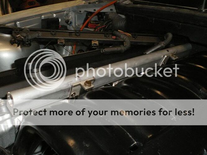

-8an fuel rail made fo rme by my mr ct newman. gotta love freebies. just need to weld up some brakcets and powder coat it.

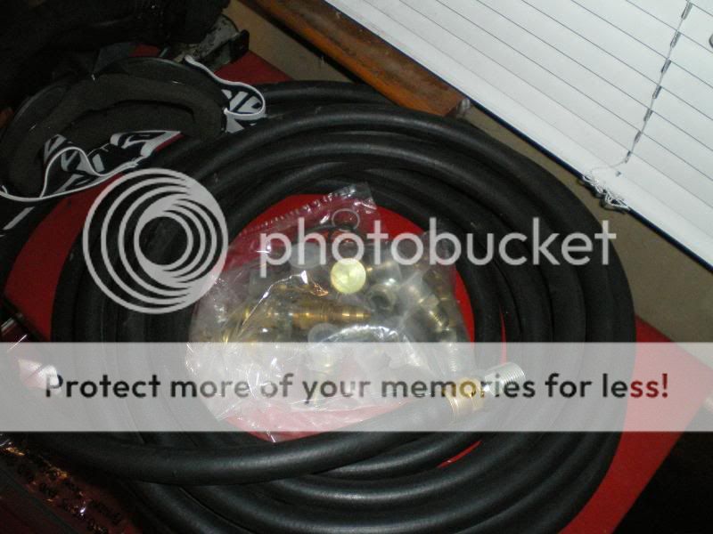

and a whole bunch of 1/2 aeroquip hose with a gang of 1/2 jic push lock fittings.
Now i just need to figure out what i wanna do for fuel filter and pressure regulator.

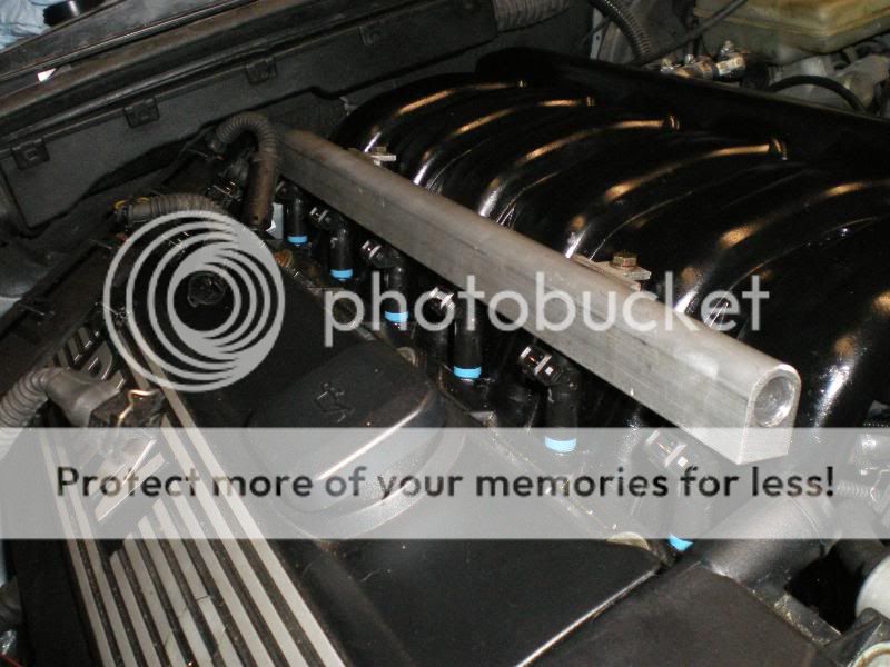

well, i cleaned up my intake manifold with soapy water since last time it was used i had some oil soup inside there. I also gave it a fresh coat of paint since it was looking pretty beat. I started fitting up my injectors and rail and looks like ill be able to retain the inj harness with minor modification. ill have to take about 1.5 to 2in off each end of the fuel rail, I asked my buddy to keep it long on each side so i can cut it down to length. Ill have to get 2 tabs welded to the rail to hold it down and call it a day. fuel stuff should be here within a couple days. yay

ok, so after the super bowl i decided to look into the fuel rail a bit more. I decided to chop off 3/4 in each side and retap. i didnt have a 1/2npt tap on hand so ill have to finish tapping that tomorow. I took some 304 ss angle and chopped it up to how it is in pictures. i drilled and tapped the rail 10/32 and counter sunk the bracket for a nice flush fit of ss flat head alen bolts. ive decided to polish the fuel rail and possibly do the hold downs in translucent grape to match my motor theme. the rails hold downs are a bit rough but ill be smoothing them out and powder coating them when i gather enough stuff to make a powder coat trip.
